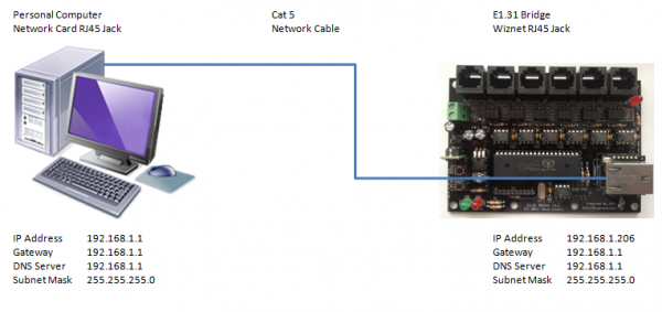

Direct Connection PC to Device
It is possible to use a single ethernet cable to connect a E1.31 controller or bridge directly to a PC without other networking gear. E1.31 uses ether net connections (RJ45 cables). To connect directly, it is necessary to put the PC and the E1.31 on the same IP subnet, ie: that they both have an address that has the same first three IP address settings like: 192.168.1.x or 192.168.0.x By default many of the E1.31 devices come with a default address of 192.168.1.206.
For assistance setting the IP address in a PC:

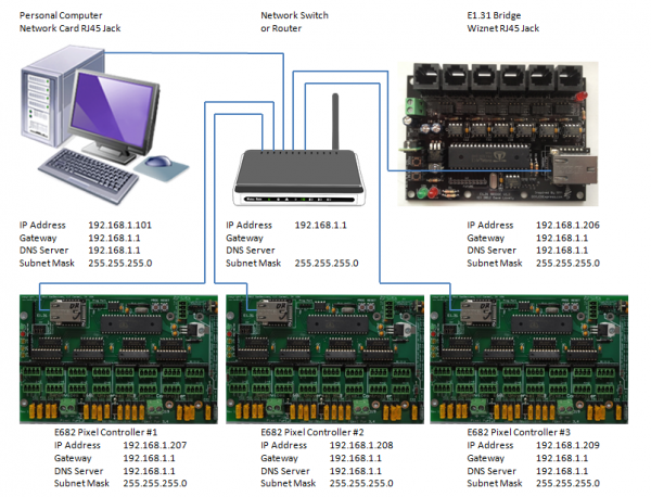

Use of Switch or Router to Connect PC and Multiple Devices
It is also possible to connect an E1.31 controller or bridge to an existing home network by plugging the device into a low cost ethernet switch or router. This configuration also allows multiple E1.31 controllers or bridges to be controlled by one main PC. It is also possible to use multiple PCs to send data to the controllers over the network. It is necessary to put the PC and all of the E1.31 devices on the same IP subnet, ie: that they both have an address that has the same first three IP address settings like: 192.168.1.x or 192.168.0.x By default many of the E1.31 devices come with a default address of 192.168.1.206. If you are using multiple E1.31 devices, it is necessary that you change the default IP address of the additional units to another address other than 192.168.1.206 so that you can access the configuration page of all of the E1.31 devices.

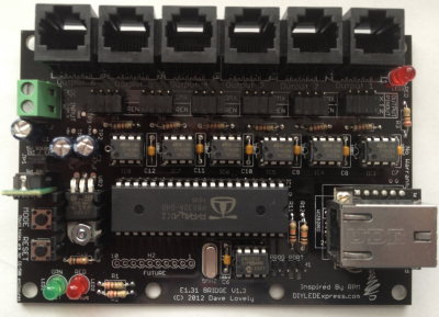

Another common usage of E1.31 is an E1.31 Bridge. An E1.31 bridge bridge is a device that allows your PC to communicate with a large number of Renard or DMX controllers using regular Ethernet network connections. It replaces multiple DMX or RS485 dongles with one configurable device that can be mounted in an enclosure in the yard and only requires one Ethernet Cat5 cable (or WIFI) back to your PC or home network. It allows up to 6 DMX universes or Renard networks to be easily controlled from your sequencing software with a minimum amount of wire from your show PC to your controllers. The bridge works with all Renard, DMX and LOR (using DMX) controllers. A common E1.31 Bridge is:
- 6 Port E1.31 Bridge by DIYLEDEXPRESS.
- ECG-DR4 and the ECG-D4 by J1SYS.
- AlphaPix 4 (1 port), AlphaPix 16 (3 ports) by HolidayCoro.com

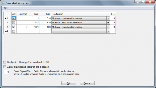

First you must create your 1200 channels in your software of choice (Vixen, HLS, Nutcracker, Xlights, LSP, LOR, etc...)
Output Plugin Channel Mapping
Next you must setup your E1.31 Output Plugin. In this example, you need 1200 channels mapped. Since the E682 can only use 510 channels per universe, you need just over 2 universes to map all of the channels. (510 + 510 + 180 = 1200)
- You map the first 510 channels of the data you want to send to your E682 in Universe 1 (in this case sequence channels 1-510).
- You map the second 510 channels of data you want to send to your E682 in Universe 2(in this case sequence channels 511-1020).
- You map the remaining 180 channels of the data you want sent to your E682 in Universe 3 (in this case sequence channels 1021-1200)
Your output plugin will look something like this:

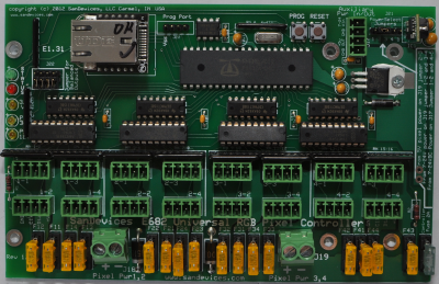

E682 Pixel Controller Channel Mapping to Output Connectors
Next you must configure your E682 using the instructions from Sandevices. There are two major versions of the firmware available depending on when you purchased the unit and if you have upgraded the firmware in your controller:
- Version 2 software is the older command line interface software
- Version 4 is the newer drop down configuration software.
Next you must map the incoming E1.31 Universe data to the physical outputs to the Pixel strings. You must also map the Universe numbers (in this case 1-3) to the 7 (Multicast) or 12 (Unicast) slots available in the controller.
Cluster 1 Mapping
In this example you have 2 strings of 100 pixels in Cluster 1 (using connectors 1-1 and 1-2). You configure cluster 1 for 2 strings of 100 pixels using the E682 configuration webpage. That is a total of 200 pixels, or 600 channels (3x200). That requires slightly more than 1 universe of data.
- So you set the Start Universe as Universe 1 and the Start Channel (of the universe) to 1.
- The software will automatically calculate the End Universe and End Channel. In this case those values would be Universe 2 End Channel 90.
So the first cluster used 600 channels of data, 510 channels from Universe 1 and 90 from Universe 2. (510 + 90 = 600)
Cluster 2 Mapping
Next you have 4 strings of 50 pixels in Cluster 2 (using connectors 2-1, 2-2, 2-3, 2-4). You configure Cluster 2 for 4 strings of 50 pixels using the E682 configuration webpage. This is a total of 200 pixels, or 600 channels (3x4x50). That requires slightly more then 1 universe of data.
- Since you ended the first cluster off at Universe 2 Channel 90, the next available channel is Channel 91. So you set the Start Universe as Universe 2 and the Start Channel (of the universe) to 91.
- The software will automatically calculate the end Universe and End Channel. In this case those values would be End Universe 3 End Channel 180.
So the second cluster also used 600 channels of data, 420 channels of data from Universe 2 and 180 from Universe 3. (420 + 180 = 600)

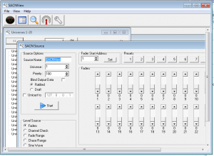

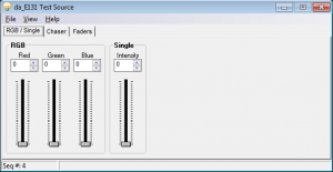

Tools for Testing E1.31 Hardware and Connections
These free tools allow you to test E1.31 controllers simply without using sequencing software. They are good tools to use when troubleshooting a E.131 network setup. If you are having trouble setting up your network, this allows you to isolate if it is the output plugin in your sequencing software or some networking setup issue preventing your setup from working. It is also a simple way to run basic chases and colors to test your pixel strings.
