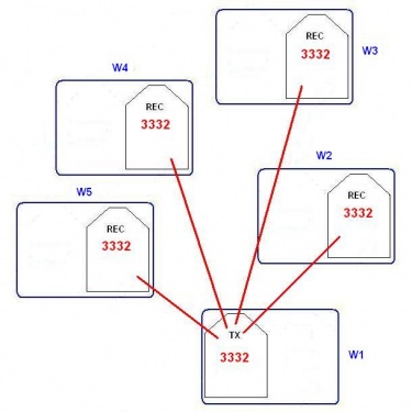

Global broadcast
- Configure all XBee modules with the same PAN ID (or just keep the default 3332). When the first one (e.g. the "master") transmits the Vixen control signals, all the other XBee modules will receive them simultaneously, and all the Renard SS controllers will respond identically. Example: for a 24-channel system, if SS8 controllers are mixed with SS16s and SS24s, the SS8s will respond to Vixen channels 1-8, the SS16s will respond to Vixen channels 1-16 and the SS24s will respond to Vixen channels 1-24.
- In a global broadcast mode, only one Ren-W board is used as the master transmitter and all the other Ren-W boards are receivers only, so each Ren-W board would require only one XBee module. The design of a global broadcast network looks like the example above.
- A special version of Renard firmware is available that allows using the global broadcast mode while still retaining individual channel selectability with each controller. The feature is called the Renard Start Address and the configuration guide can be found here: Renard Start Address Configuration Guide.

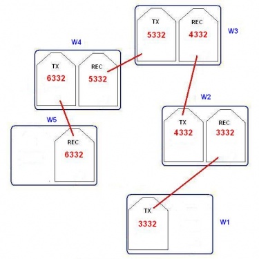

- PTP mode enables the "daisy-chain" function that allows multiple Renard SS controllers to have their own ranges of channels which is more in keeping with the way most people use Renard controllers. Two PTP options are available: the standard and alternate methods. To accomplish this, think of the wireless system as a replacement for the cat5 wires: the RJ45 plugs are the individual XBee modules and the cat5 wire is replaced by the wireless radio signal. The first SS controller gets the first group of Vixen channels, the next controller in the chain gets the next group, etc. just as if the controllers had been daisy chained using cat5 cables. To configure the Ren-W network to simulate the cat5 wiring scheme, the first Ren-W board needs to be a transmitter only. It's PAN ID must be set to the same number as the next Ren-W's receiver module. (The second Ren-W would have two XBee modules -- one to receive and the other to retransmit the Vixen commands to the next Ren-W board) The second Ren-W board's XBee transmitter would have a different PAN ID than its receiver, and the third Ren-W board's receiver would have the same PAN ID as the second Ren-W's transmitter. This scheme continues until the last Ren-W which would be only a receiver and have only one XBee module.
- In the above standard PTP example, imagine that Ren-W1 is the main transmitter connected to the computer and all the other units are 24-channel Renard SS24, for a total of 96 channels.
- Ren-W1 (main transmitter) has PAN ID (3332), which matches the W2’s receiver so the two can communicate with one another. Therefore, W2 takes Vixen channels 1-24 and passes 25-96 on to the next Ren-W in the chain.
- The W2’s transmitter (PAN ID 4332) communicates with the W3’s receiver. Being the second controller in the chain, the W3 takes Vixen channels 25-48 and passes 49-96 on to the next Ren-W in the chain.
- The W3’s transmitter (PAN ID 5332) communicates with the W4’s receiver. Being the third controller in the chain, the W4 takes Vixen channels 49-72 and passes 73-96 on to the next Ren-W in the chain.
- The W4’s transmitter (PAN ID 6332) communicates with the W5’s receiver. Being the fourth controller in the chain, the W5 takes Vixen channels 73-96.
- Summary: the standard PTP method uses matching pairs of PAN IDs to determine which modules connect to one another. Repeater Ren-Ws must each have two XBee modules using the PANID example above.
