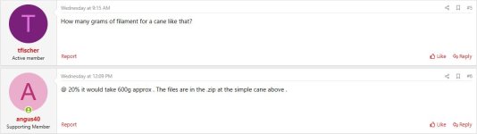

I’m just curious but what is the advantage of these being printed as opposed to the regular (HDPE) plastic? Is it just longevity only, the free diffusion or maybe an easier assembly?
At 600 grams (1.32 pounds) per cane, they certainly weigh more than the standard ones. A quick Google search says that 600 grams of translucent or clear generally costs between $20 and $35 USD. That’s substantially more than the $3 that I’m buying the extruded ones for, minus the lights that are never useful to me.
