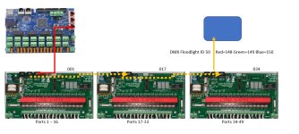

I have 3 Express boards connected together. They get their data feed from my Falcon F16V4.
The boards are setup with ID's of 001, 017, 034.
In Xlights I can control all 16 ports on each controller. Xlights F16V4 DMX Port 1, Express lights 1 thru 49.
Running a sequence from Xlights and everything works.
Now I attach my DMX floodlight setup as #50 and XLights sees in test mode Red=148 Green=149 Blue=150
When I run a sequence from XLights and the floodlight is activated, Random lights on the 3 express boards start flashing as if they are configured to turn on and off YET I have no part of the sequence using the express ports.
Anyone ever seen this before?
Is there something I am overlooking?
I have been trying to figure this out for over 2 weeks now.
Thanks
