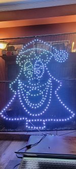

I made a new 6' talking tree with santa hat (blatant copy of EFL). I just looked at the image and made it as close as I could, its attached to tenax using 4" cable ties. The seeds used for this were 4" spacing (too much, 2" would have been better). A lot of 4" cable ties but it came out great. I made the model and sub models myself. All total it was around 496 pixels (not in front of xlights). I am all in on seeds now. I hope to create a few 3d printed props using them over the next few months.

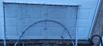

Attached is what mine looks like after I took it down. 14 strings of 120 seeds zig zag (X4) so 30X56 = 1680 pixels. 5v with no PI, 1" spacing.

I bought the roll of seeds from Ray. Those are the original one's he offered which use 24 or 26ga wire (very thin). There was no need to cable tie every inch, every 6 or so was fine to keep things lined up. I have since bought a few thousand of the 2" and 4" spaced seeds from Ray with the new 20ga wiring and they are so much better to work with (my talking tree is made with the 4" seeds). I would strongly suggest going the 20ga route. I kept 2 spare strands as backup in case I ran into issues but 2 seasons of Xmas and Halloween and not an issue. I think the key to longevity for these is to support them. Don't depend on the strand to support itself or allow it to move around on its own.
