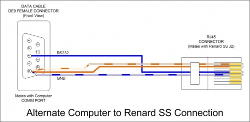

:'''Data cables for Renard SS board hookup directly to computer COMM port''' | :'''Data cables for Renard SS board hookup directly to computer COMM port''' | ||
[[image:Wiki - Renard SS RS232 Data Cable2.jpg | | [[image:Wiki - Renard SS RS232 Data Cable2.jpg | 500px ]] | ||
{| border="1"; cellpadding="10" style="text-align: center; background:black; color:white" | |||
|colspan="3" align="center" style="background:#FBEC5D; color:black"| '''PC Serial Port to REN 32'''<br>'''Adapter Cable''' | |||
|rowspan="2" style="background:#AFEEEE; color:black"| '''RS232 Pin # | |||
!width="200" style="background:#D3D3D3; color:black"| REN 32 RJ45 | |||
|style="background:#AFEEEE; color:black"| '''PC DE9 Pin 3''' | |||
|style="background:#FBEC5D; color:black"| RJ45 Pin 4 | |||
|style="background:#AFEEEE; color:black"| '''PC DE9 Pin 5''' | |||
|style="background:#FBEC5D; color:black"| RJ45 Pin 5 and Pin 1 and/or Pin 2 | |||

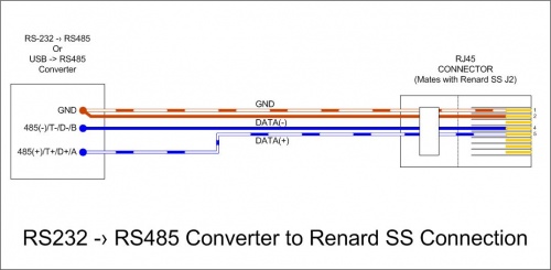

:'''Data cable for Renard SS board hookup using a RS232->RS485 or a USB->RS485 converter''' | :'''Data cable for Renard SS board hookup using a RS232->RS485 or a USB->RS485 converter''' | ||
::Due to the many different types of RS232->RS485 and USB->RS485 converters available, the drawing only refers to the signals coming from the converter. Check the documentation for your converter to figure out how/where to hook up the correct wires. | ::Due to the many different types of RS232->RS485 and USB->RS485 converters available, the drawing only refers to the signals coming from the converter. Check the documentation for your converter to figure out how/where to hook up the correct wires. An example is shown here with the [[media:Wiki - HXSP-2108F adapter.jpg |HXSP-2108F Adapter Hook-up ]] | ||
[[image:Wiki - Renard SS RS485 Data Cable.jpg | | [[image:Wiki - Renard SS RS485 Data Cable.jpg | 500px ]] | ||
|colspan="3" align="center" style="background:#FBEC5D; color:black"| '''RS485 Dongle to REN 32'''<br>'''Adapter Cable''' | |||
|rowspan="2" style="background:#AFEEEE; color:black"| '''RS485 Pin # | |||
|style="background:#AFEEEE; color:black"| '''RS485(-)/T-/D-/B/485-''' | |||
|style="background:#FBEC5D; color:black"| RJ45 Pin 4 (blue CAT5 wire) | |||
|style="background:#AFEEEE; color:black"| '''RS485(+)/T+/D+/A/485+''' | |||
|style="background:#FBEC5D; color:black"| RJ45-pin 5 (blue/white CAT5 wire) | |||
|style="background:#AFEEEE; color:black"| '''GND''' | |||
|style="background:#FBEC5D; color:black"| RJ45-pins 1 & 2 (orange and orange/white CAT5 wires) | |||

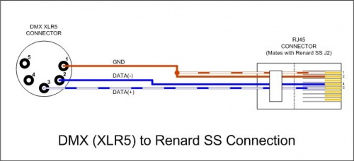

:'''Data cable for Renard SS board hookup in a DMX environment''' | :'''Data cable for Renard SS board hookup in a DMX environment''' | ||
[[image:wiki - DMX (XLR) to Renard SS Connection.jpg | | [[image:wiki - DMX (XLR) to Renard SS Connection.jpg | 500px]] <br> | ||
|colspan="3" align="center" style="background:#FBEC5D; color:black"| '''DMX using XLR Connectors'''<br>'''Adapter Cable''' | |||
|rowspan="2" style="background:#AFEEEE; color:black"| '''DMX XLR Pin # | |||
|style="background:#AFEEEE; color:black"| '''XLR connector Pin 1 (GND)''' | |||
|style="background:#FBEC5D; color:black"| RJ45-pin 1 and/or pin 2 | |||
|style="background:#AFEEEE; color:black"| '''XLR connector pin 2 (Data-)''' | |||
|style="background:#FBEC5D; color:black"| RJ45-pin 4 | |||
|style="background:#AFEEEE; color:black"| '''XLR connector pin 3 (Data+)''' | |||
|style="background:#FBEC5D; color:black"| RJ45-pin 5 | |||

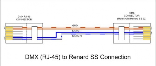

[[image:wiki - DMX (RJ-45) to Renard SS Connection.jpg | 500px]] | |||
|colspan="3" align="center" style="background:#FBEC5D; color:black"| '''DMX using RJ45 Connectors'''<br>'''Adapter Cable''' | |||
|rowspan="2" style="background:#AFEEEE; color:black"| '''DMX RJ45 Pin # | |||
|style="background:#AFEEEE; color:black"| '''RJ45 connector pin 1 (Data+)''' | |||
|style="background:#AFEEEE; color:black"| '''RJ45 connector pin 2 (Data-)''' | |||
|style="background:#AFEEEE; color:black"| '''RJ45 connector pins 7 & 8 (GND)''' | |||
|style="background:#FBEC5D; color:black"| RJ45-pins 1 & 2 | |||

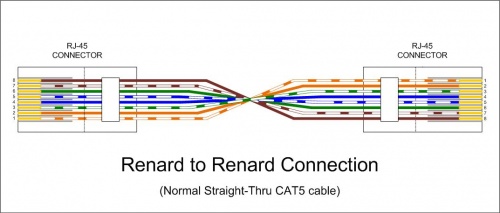

:'''Data cable for Renard SS board hookup to other Renard boards''' | :'''Data cable for Renard SS board hookup to other Renard boards''' | ||
[[image:Wiki - Renard to Renard Data Cable.jpg | | [[image:Wiki - Renard to Renard Data Cable.jpg | 500px]] <br> | ||
Generally only a regular straight-thru CAT5 cable is required to connect Renard SS boards to other Renard boards. | Generally only a regular straight-thru CAT5 cable is required to connect Renard SS boards to other Renard boards. |
