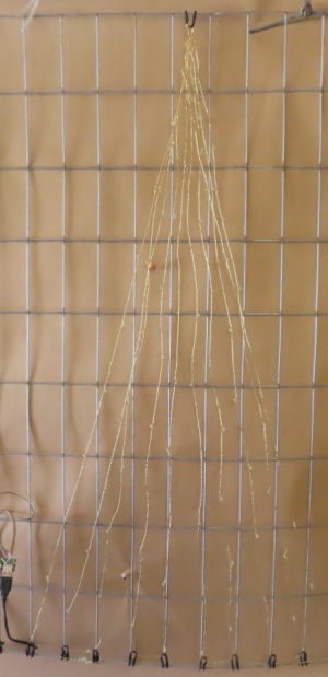

Following the large version of the Schematic above as a guide, and starting with the USB connector end of the string, secure the string in the Double-J hook at location "S" in the diagram.
Proceed to string the fairy lights to each Double-J hook in turn, in the following order:
- S (Start) => T => 2 => 3 => T => 4 => 5 => T => 6 => 7 => T => 8 => => 9 => T => F (Finish)
- At the finish you will probably have a small amount of the fairy string remaining; just place it to the left along the bottom wire of the fence and secure the end. If you run a little short of fairy lights, extend its length by attaching some small gauge telephone wire to complete the design. The small variation will not be noticeable in the end product.
- At this point you will have 5 strands of fairy lights in the top Double-J hook that is dangling by only one of its "J"s. The final step is to hook both "J"s to the top wire and squeeze the wire ends to close-up the loop so that it will stay attached to the top wire of the fence. Remember that the top Double-J hook does not straddle one of the vertical wires. It is attached between vertical wires 5 and 6.
Repeat the process above for remaining trees, connect to your controller, and you're good to go.
Here's how a finished tree will look. Don't worry that all the strands aren't perfectly aligned; the overall display will look good.
