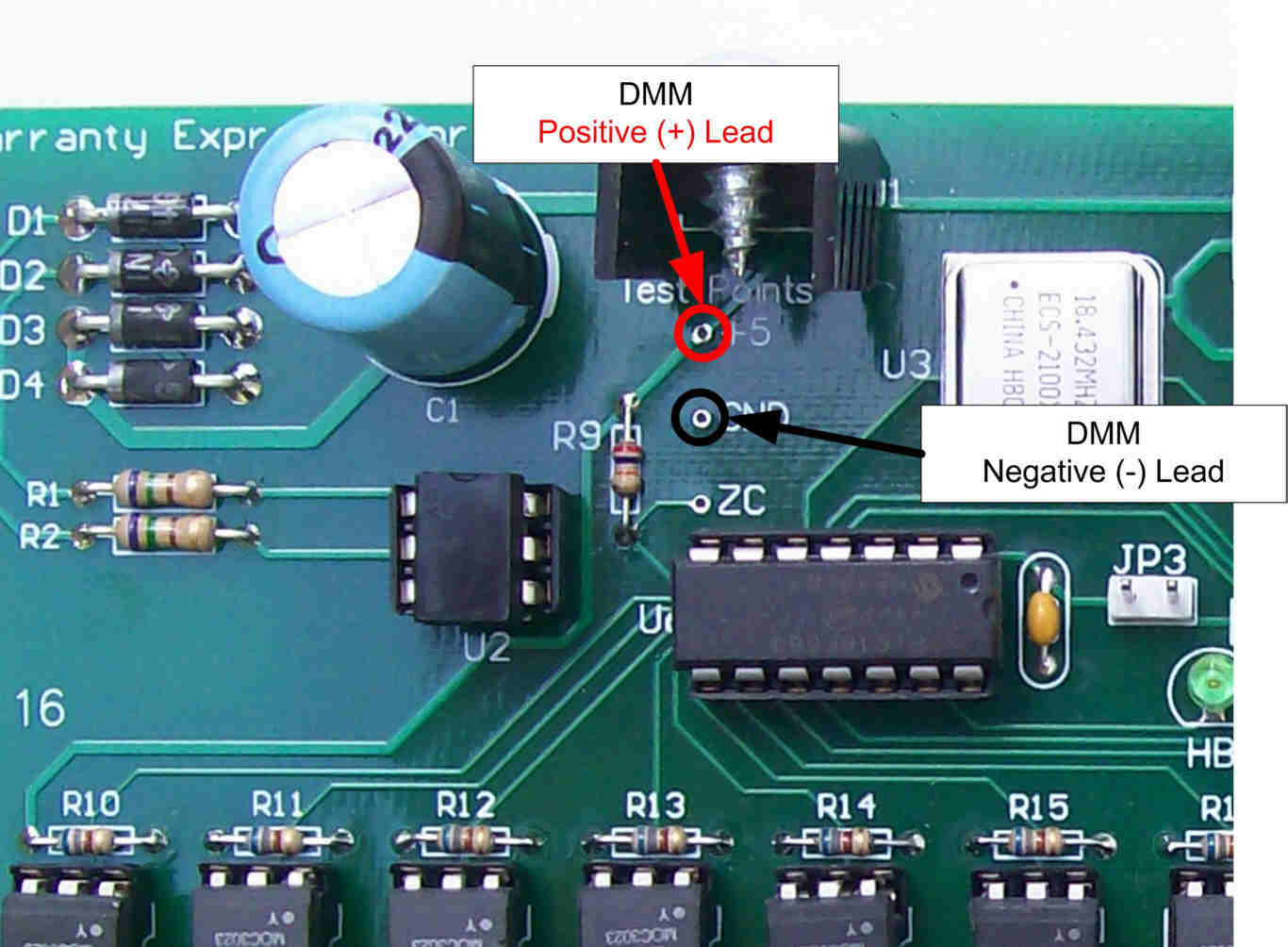

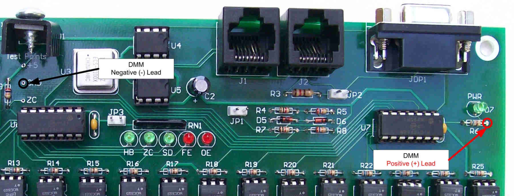

- Measure DC voltage at +5 Test Point.
- Voltage should be +5 VDC +/- 0.05
- If incorrect, go to step 13
- Did the PWR LED light?
- If it did, go to step 21

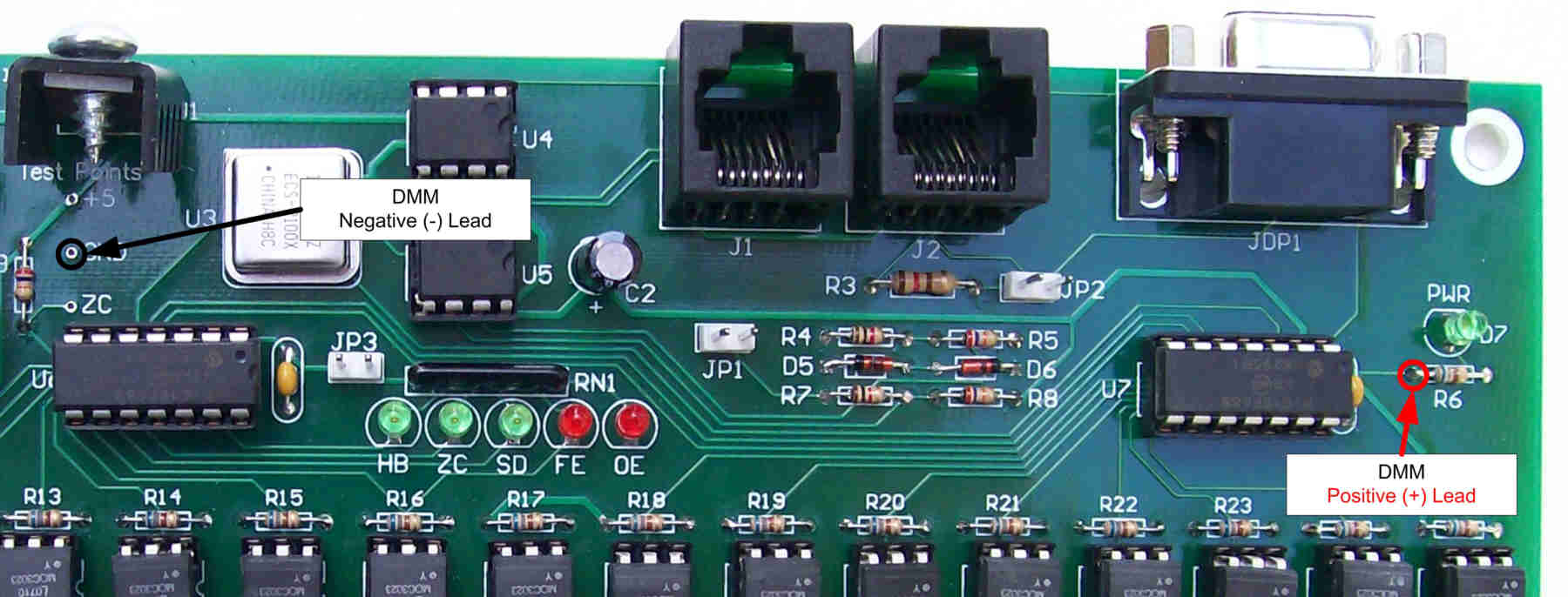

- Measure DC voltage on  right side of R6.
- If voltage is approx. 2.0-3.0 VDC, replace the LED and retest
- If voltage is approx. 5.0 VDC, then either the LED is installed backwards or is bad
- Measure DC voltage on  left side of R6.
- Voltage should be approx. 5.0 VDC.
- If correct, then double check the value of R6 and/or replace R6
- If this is incorrect, restart the troubleshooting process.

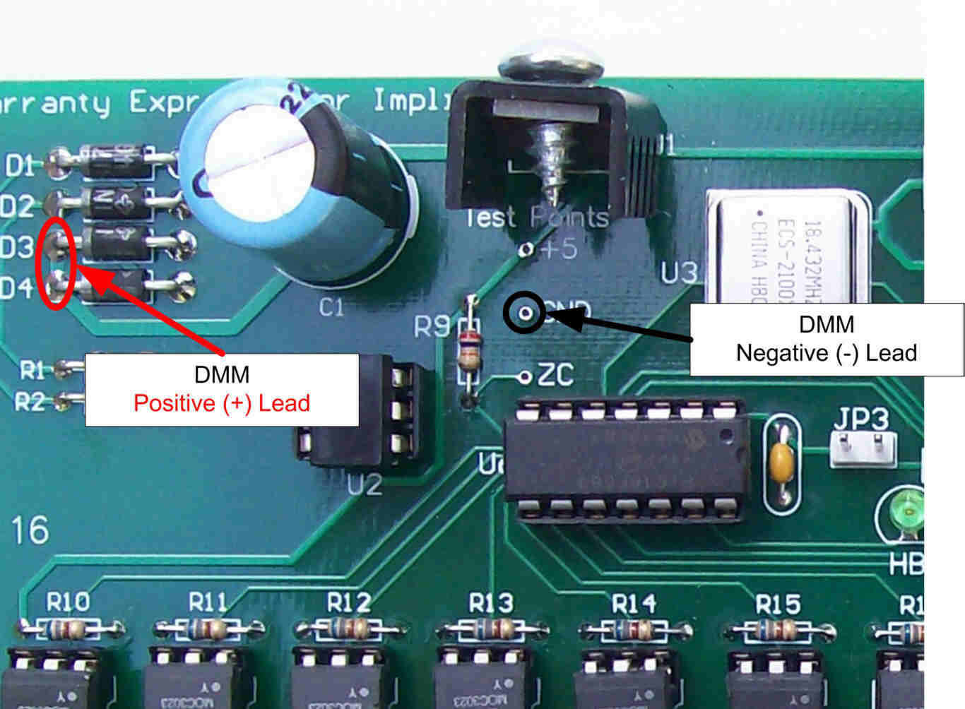

- Measure DC voltage at  cathode of D3 & D4.
- Voltage should be above +6 VDC but less than +12 VDC.
- If correct, voltage regulator U1 is probably bad.

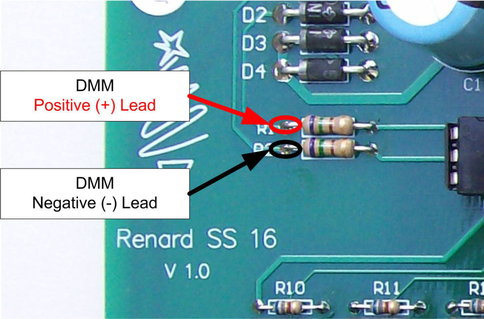

- Measure AC voltage  between R1 and R2.
- Voltage should be above 6 VAC
- If correct, one or more diodes D1 thru D4 could be bad or incorrectly installed.

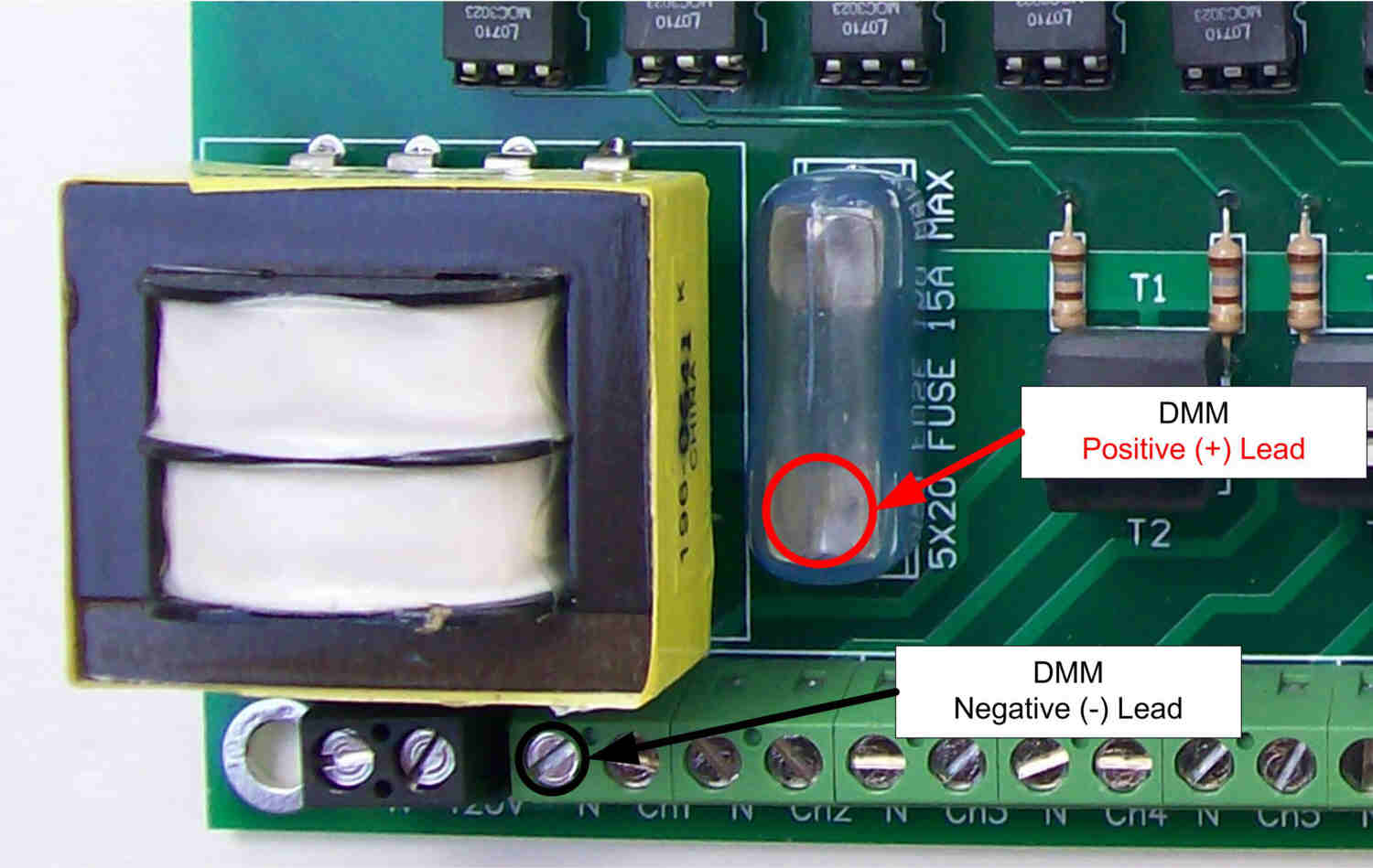

- Measure AC voltage between  top side of F1 and any N terminal.
- Voltage should be 115-120 VAC
- If correct, transformer TF1 is probably bad.

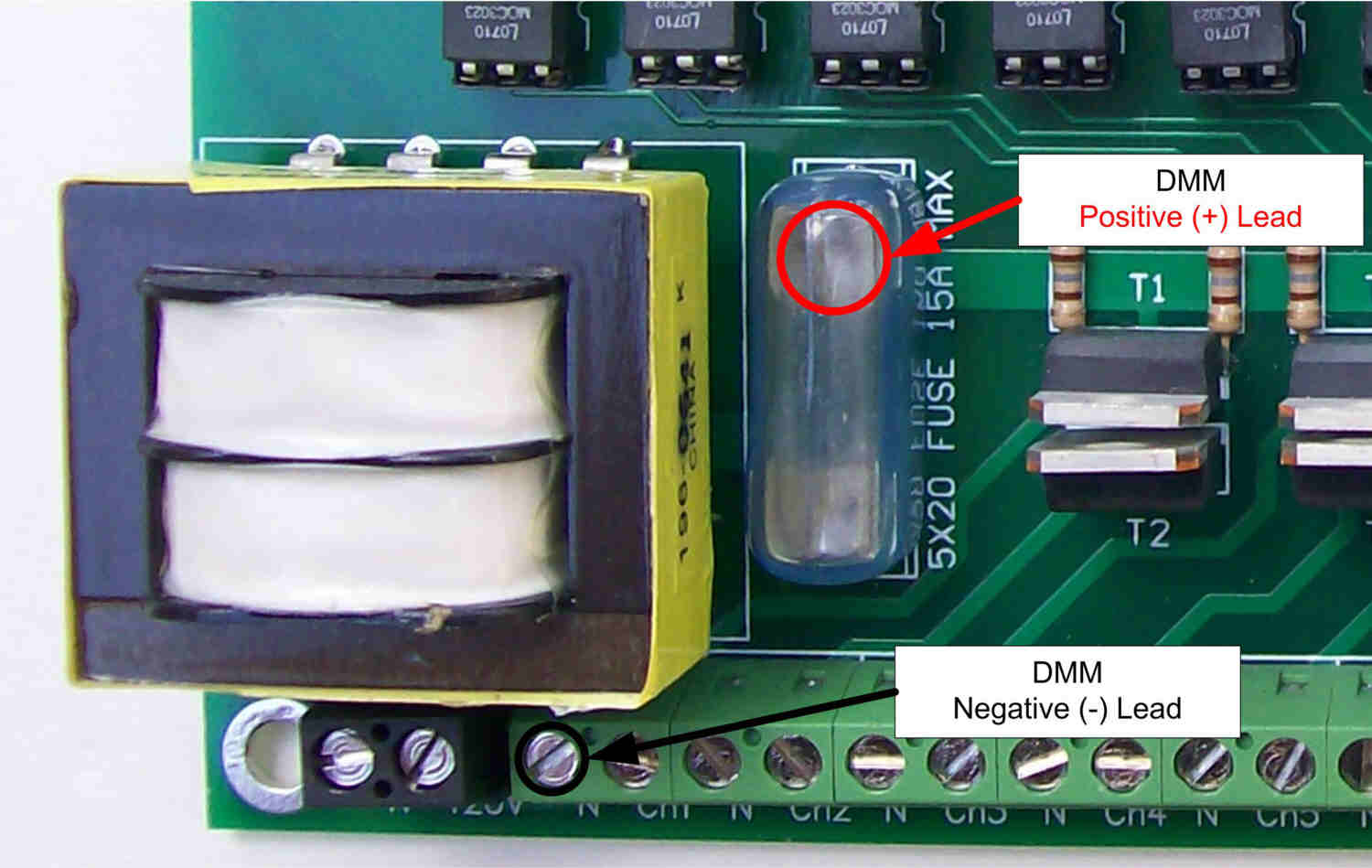

- Measure AC voltage between  bottom side of F1 and any N terminal.
- If correct, fuse F1 is probably bad.

Verifying Diagnostic LEDs
- Turn OFF AC power
- Remove PIC chip U6
- If not already installed, place a shunt (jumper) on JP3.
- Turn ON AC power
- Power LED should be lit and the DC voltage at the +5 Test Point should be 5.0 (+/- .5) VDC.
- If incorrect , then go to Troubleshooting Power Problems
- Momentarily connect a jumper (small piece of wire) between U6  IC socket pin 13 and pin 14
- HB LED should light
- Momentarily connect a jumper between U6  IC socket pin 10 and pin 14
- ZC LED should light
- Momentarily connect a jumper between U6  IC socket pin 9 and pin 14
- SD LED should light
- Momentarily connect a jumper between U6  IC socket pin 8 and pin 14
- FE LED should light
- Momentarily connect a jumper between U6  IC socket pin 7 and pin 14
- OE LED should light
- If all the LEDs in steps 6 thru 10 did light, then the diagnostic LEDs are operational.
- If all of the LEDs in steps 6 thru 10 did not light:
- a.  Check for 5.0 VDC at  U6 IC socket pin 1
- If incorrect, check the solder pads and/or go back to Troubleshooting Power Problems
- b. Remove shunt from JP3
- c.  Check for 5.0 VDC at  left side of JP3
- d. Install shunt on JP3
- e.  Check for 5.0 VDC at  right side of JP3 (on underside of board).
- If incorrect, replace the shunt (jumper)
- f.  Check for approx. 5.0 VDC on the  pins (on underside of board) of resistor network RN1.
- If correct, then probably all the LEDs are installed backwards
- If incorrect, replace RN1
- If any (but not all) of the LEDs in steps 6 thru 10 did not light, measure the DC voltage at the appropriate location on the IC socket for U6.  The voltage measured at each location should be approximately 3.0-3.5 VDC.
 Diagnostic LED Measure DC voltage at HB U6 IC socket pin 13 ZC U6 IC socket pin 10 SD U6 IC socket pin 9 FE U6 IC socket pin 8 OE U6 IC socket pin 7
- If any voltage measured in step 13 was 0 VDC, then most probably the associated LED is installed backwards.
- If any voltage measured in step 13 was 5 VDC, then most probably the solder pads for the associated LED are bridged.
