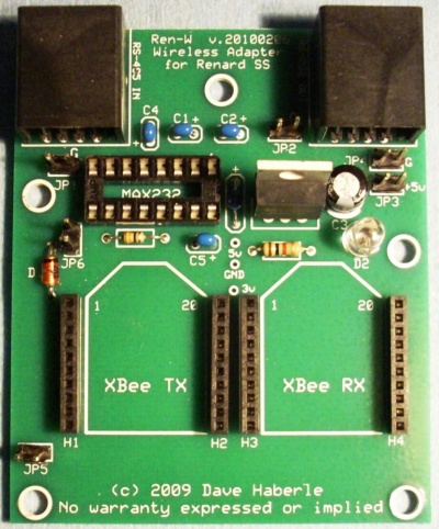

PCB Parts Layout
Construction Step-by-step
1. Solder 2mm female headers at locations H1, H2, H3, H4 or:
TX only: only H1, H2 are required
RX only: only H3, H4 are required
E-mode repeater: only H1, H2 are required.
Normal repeater mode: all four headers required
2. Solder the 16-pin DIP socket into the MAX232 location. Note the position of pin 1; the notch faces to the right. If no socket is to be used, solder the MAX232 directly to the Ren-W board; verify the pin orientation before soldering.
3. Solder capacitors C1 and C2. You may wish to straighten the leads to fit the holes better. There are no polarity concerns for non-polarized capacitors. (Note: The polarity markings on the board are for the convenience of users who are using electrolytic capacitors instead of the non-polarized type.
4. OPTIONAL: Solder non-polarized capacitors C4, C5 and C6. Like C1 and C2, if electrolytic capacitors are used, observe the + polarity markings on the board. (Note: C4, C5 and C6 do a lot to clean up the RS-232 signal the Ren-W provides to the Renard controller, and these are essential if connecting the Ren-W to a Ren-C/595 or Ren-C/Grinch. However, in testing, C4, C5 and C6 were proven to be unnecessary when using the Ren-W with Renard SS controllers.)
5. Solder electrolytic capacitor C3. Note the polarity: the + side into the square pad (top) closer to jack J2 which means the stripe on the capacitor faces DOWN.
6. Solder 2-pin headers JP1, JP2, JP3, JP4, JP5, JP6. (Note: JP1 and JP2 are optional.)
7. Solder RJ45 jacks J1, J2
TX only: only J1 is required
RX only: only J2 is required
Normal repeater and E-mode repeater: both J1 and J2 are required
8. Solder zener diode D1. Note the polarity – the band on the diode must be facing up, next to header JP6.
9. Solder resistors R1 (orange-orange-black) and R2 (brown-black-red). R2 is only required if the optional power LED (D2) is used. No polarity concerns.
10. Solder the optional power LED at position D2. Note the polarity – the flat side/cathode/shorter lead faces to the mounting hole immediately to the right of D2.
11. Solder the 3.3v voltage regulator U1. The heat sink side faces toward JP2 (top). The need for an additional heat sink is highly unlikely as the supply voltage is only 5vdc.
12. Install the MAX232 and XBee module(s) in their respective sockets: use the XBee RX side for a receive-only board, the XBee TX side for a transmit-only board. Note the position of pin 1.
13. Install optional jumper shunt at JP6 if necessary. This bypasses the R1 resistor (33 ohms) and allows a weaker RS-485 signal through to the XBee radio in transmit mode. Normally, this jumper shunt is not necessary.
14. Install optional jumper shunt at JP5 if necessary. This makes the Ren-W into an E-Mode repeater where a single XBee module in the TX position serves as both the receiver and transmitter.
15. CAUTION: Never place jumper shunts across JP1 or JP2!
16. CAUTION: Never place jumper shunts across either pin of JP3 to either pin of JP4!
