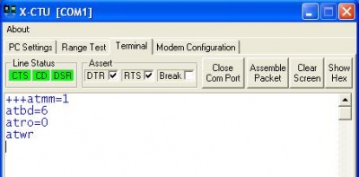

- 8. Select the Terminal tab.
- 9. Type +++ by itself but DO NOT PRESS THE ENTER KEY. Wait about 4 or 5 seconds.
- 10. Type ATMM=1 and press ENTER, then wait about 4 seconds. This command sets the MAC mode to the No Acks setting.
- 11. Type ATBD=6 and press ENTER, then wait about 4 seconds. This command sets the BAUD rate to 57,600.
- 12. Type ATRO=0 and press ENTER, then wait about 4 seconds. This sets the packetization timeout to zero.
- 13. Type ATWR and press ENTER, then wait about 10 seconds. This writes the changes to the XBee's internal memory.
