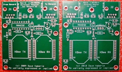

The Ren-W circuit board is a very simple design but good soldering technique is still extremely important.
Voltage Measurements: three test points are just below pin 16 of the MAX232 chip/socket (circled in red):
Construction Mistakes
- Be certain that the following components are mounted on the board properly:
 - The notch on the MAX232 chip faces to the right, toward the U1 voltage regulator.
 - The zener diode (D1) has the black stripe on the TOP, next to the JP6 header pins.
 - The 3.3 voltage regulator (U1) has the metal tab facing up, toward the JP2 header pins.
 - The electrolytic capacitor (C3) has the - stripe facing DOWN toward the LED, which means the + side is up toward the J2 jack.
 - Capacitors C1, C2 and C3 are needed at the very least and you may find that your Ren-W works fine without optional capacitors C4, C5 and C6. However, these three additional capacitors do a lot to clean up the RS-232 serial signal output and adding C4, C5 and C6 are highly recommended if you encounter inconsistent communication from the Ren-W to your Renard controller.
 - If using an electrolytic capacitor for C1, C2, C4, C5 or C6, be sure its polarity is correct. The + sides are marked on the board; the opposite side it obviously the - side, which is marked on the capacitor itself.
 - The LED (D2) while not very clear in this photo, has the cathode (flat side) facing the mounting hole to its right.
 - Resistor R1 (33 ohms) is immediately below the MAX232 chip. The resistor has no polarity concerns.
 - Resistor R2 (1k ohms) is immediately below the U1 voltage regulator. The resistor has no polarity concerns.
 - Be sure to observe the XBee module's orientation as printed on the board; remember that the standard board has the XBee pointing upward while the SMA board has the module pointing downward. If you have the standard board, DO NOT simply turn the module around to point downward for an XBee module with an SMA connector -- it will not work and you may damage the radio when power is applied!
