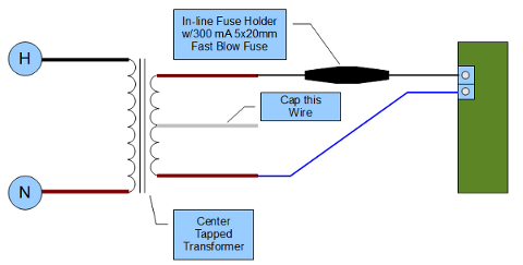

 - In normal use, the Renard 64XC does not require a fuse.  However, since this section is about "problems", it is prudent to have one installed.  The best way to do this is with an in-line fuse holder on the incoming power.  Mouser PN#576-150274 (holder) and PN#576-0235.300MXP (fuse) are perfect for this.
 - If not installed already, install an appropriate rated fuse in the SSR fuse holder. Use the smallest value fuse that you have available for this portion of testing.
- Using a smaller fuse here is for safety during initial power testing. If there are any problems with bad triacs, bridged solder pads or a bad transformer during first power application, a small fuse will blow before any permanent damage to the SSR PCB can occur. For testing one SSRez channel at a time (for example), the recommended fuse size is 1A. This is a standard 5x20mm fuse available most anywhere.
