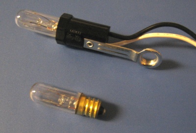

- Candelabra socket with a mounting bracket. Example: Servalite CS-10014-52U. (Lowe's, about $2.75). This socket does not have any electrical connection to the mounting bracket.
- 15watt, 120vac tubular light bulb with candelabra mount. (Lowe's, 2 for approx $3.00) These are quite small, about 2" long and 1/2 inch across.

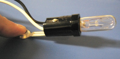

- Step 1 - Flatten the bracket on the candelabra socket with a pliers. Leave it slightly bent so that when mounted, the bulb will be raised away from the case.

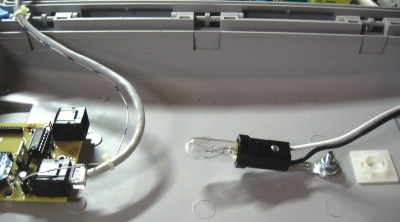

- Step 4 - Put a washer on the screw and insert the screw through the hole. Place another washer over the screw on the inside, then apply the candelabra bracket, followed by another washer and finally the nut. Tighten very snugly.
- Step 5 - Screw in the bulb, connect a piece of SPT-1 wire (without a plug attached) using either wire nuts or solder to the candelabra socket's leads, covering with shrink-wrap. The length of the wire you need is dependent on where you intend to plug the bulb into A/C power. In this example, a A/C pirate plug was attached to the connecting wire between the two 12-channels halves of the SS24 board. If you choose to plug the heater into an external plug, then fish the SPT wire out of one of the holes in the bottom of the case.
- Step 6 - Apply the plug to the SPT-1 wire, and plug it in.
