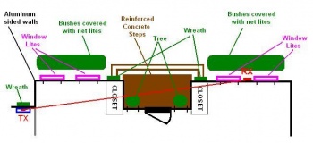

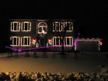

- Here's an example of my own attempts to make something work that couldn't possibly work. The sympton was a remote controller with a Ren-W that was behaving quite erratically and rarely in sync with the rest of the lights. Sometimes it wouldn't fire any channels at all. This Ren-W/Ren64 controlled the lights on the entire left front side of the house (4 windows, 1 wreath, 1 tree, and sets of net lights on bushes) so when it was misbehaving, it was pretty obvious, and really ugly to watch.
- The transmitter is located inside the garage against the back wall of a cabinet. It's a Rev-6 Ren-W board with an XBPro - SMA version, with an 11" (9db gain) wi-fi whip antenna, pointed vertically. The house has aluminum siding on all outside walls so I thought maybe the 9db gain whip antenna would overcome the attenuation from the aluminum siding.
- The receiving Ren-W (also a Rev-6 board) was attached to a Ren64 and inside a CG-2000 case, sitting on the ground behind bushes on the front of the house, about 75 feet away (straight line). The XBPro radio inside had the 1" mini-whip antenna, and it was aligned vertically to match the transmitter.
- The photo of the front of the house has notations of where the transmitter and receiver were. The second photo is an overhead drawing of what the radio wave had to go through to get to the receiver. As it turns out, I was trying to transmit through 4 layers of aluminum siding, 6 walls, through a reinforced concrete front step, through electrical interference caused by at least two of the wreaths on the front of the house and two trees in the entryway, and of course the lights around the windows. Also, consider that the bushes the receiving Ren-W was under were also covered with net lights.
- The eventual solution was to mount an 11" wi-fi whip on top of a 2' lenghth of PVC and mount it near the center of the yard an run a wi-fi antenna extension cable from the Ren-W in the controller box to the pole-mounted antenna.
- The bottom line of this example is to consider carefully where you put the transmitter and receiver(s) so as to maximize the direct, line-of-sight communication between the units as best as is possible. The more impediments you place between the transmitter and receiver, the more misfires you'll have.
