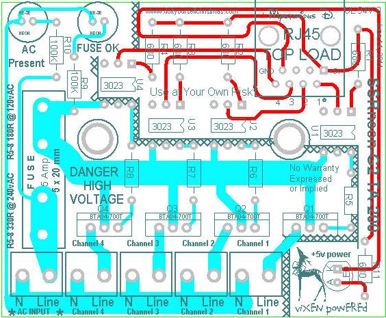

The SSRneon is a 4 port AC Solid State Relay (SSR). It is derived from the same basic design that has been in general use by the DIY community for many years. Most of the DIY SSRs are derived from Sean Bowf's original 4 port SSR. The design has evolved over the years, but the core functions and parts are the same. The SSRoz and SSRez are two such designs.
The current Version of the SSRneon is SSRneon-G2 or Second Generation SSRneon. The second generation of the SSRneon was designed to fit in one specific enclosure as detailed below.
Safety Features
ne-2E
ne-2E
The main safety feature of any SSR is the main FUSE. This is discussed in a separate section below.
The SSRneon contains two NE-2E neon light bulbs. These lights are what differentiates the SSRneon from the other available SSRs.
The point of these neon lamps is they serve as a safety warning that AC voltage (which can be lethal) is present on the SSR PCB.
One bulb lights if AC voltage is correctly attached to the board. Marked AC Present on the Boards Silkscreen (legend).
The second bulb lights if AC voltage has successfully passed through the on-board fuse. Marked FUSE OK on the Boards silkscreen (legend).
The presence of the second bulb (FUSE OK) serves as a troubleshooting device. If the AC Present bulb is lit, but the FUSE OK is not, then you know that AC is connected properly, but there is something wrong with the fuse.
Neons are used instead of an incandescent blub due to the fact that a neon bulb is very long lived and is much 'tougher' then an incandescent since there is no filament to break.
These bulbs play no role in the basic function of the relay and can be left off the board. If this is done, the two 100K resistors can also be left off the board. The 100K resistors are needed to keep the bulbs from burning out over time.

All wires attach via terminal blocks. The attachment points are along the bottom of the board facing the enclosure openings. The wire attachment is different then the other SSRs. Instead of grouping all of the neutrals and all of the 'hots' together, each individual wire 'pair' is terminated on their own terminal block. This avoids the problem of having to cut the hot and neutral wire within a pair to different lengths in order to get them to fit nicely inside the already cramped enclosure. The PCB takes care of tying all of the neutrals together for you.
heat sink
heat sink
A heatsink can be fashioned and attached to the TRIACs. Use of a heatsink should boost the continuous amp capacity from 4 amps to 7 amps. A heatsink should not be necessary unless the load for any single channel (Tirac) exceeds 1 amp. These are usually made from a piece of aluminum since it cuts and drills easily and absorbs heat rapidly. See the example to the right of a couple dozen homemade headsinks. One safety note about heatsinks. You need to be sure the TRIACs you are using have what is know as an 'isolated tab.' The tab is the exposed metal pad with the hole in it. On some TRIACs the tab is 'hot' or has AC voltage present. You should not use a heatsink that connects all of the TRIACS together unless all the TRIACs have an 'isolated tab'. The TRIAC listed in the BOM has an 'isolated tab' so it is suitable for use with a heatsink.
The board has 2 ounce copper traces for added reserve capacity and heat absorption.
TA-200
TA-200
The board has two points to mount it to the TA-200 enclosure. Great pains were taken to make sure that the screws that come with the enclosure can be used once they have been cut down to a proper length. You can use the screws that come with the enclosure provided you cut them off. The correct length of the cut off shaft BELOW the head is 5/8".
The screws that come with the enclosure are nice in that they have both a hex head and a screw driver slot for installation/removal. (Plus they are free with the enclosure!)
Home Etch
copper
copper
The board is home etch friendly. It is single sided. Effort was made to keep the traces wide with good spacing. You will also notice that all the trace corners are rounded since this makes for a better home etch. A special version of the copper side was created. It matches the layout of the production board. However, all of the large through holes have been 'filled-in with only a small dot in the middle of the copper removed. This allows the home etcher to drill these holes whatever size he likes and still have adjacent copper to the hole's edge.
Board amperage for 1 oz copper should not exceed 4 Amps. 5 Amps can be attempted with heatsinked Triacs.
The etch files are .pdf format. Be sure to print these with the actual size attributes set within Acrobat.

Construction Information
Oh, many of you will be building more than one SSRez at a time. An assembly line mindset really helps. This means, put all the resistors on all the boards before going to the next part.
Now, get your tools together! Cause here we we go.....
1. Sort your parts in the order of assembly. This sounds odd but really helps especially if you have never done this type of assembly before.
2. Check your resistors...make sure the part matches whats written on the bag. Every once in a while, the supplier will give you the wrong part. It never hurts to grab a mulitmeter and check those resistors values. Hmmmmm...how to read the color bands on the resistors can be found here.
3. Inspect your boards for damage. Basically, you are looking for cut traces, deep scratches and other damages since they were shipped.
4. Install the 5 680 Ohm Resistors marked R5, R6, R7, R8 and R9 [blue, silver, red, gold]. Bend them first to match the holes (I have been known to bend all my resistors while watching TV!) Insert them through the holes and bend the lead back to about 60 deg on both side to hold them in place. Solder each connection and trim off the excess lead with flush cut snips. Note: Some electronics folks will tell you to do this differently. There is a high specification soldering procedure (typically for military items) that says to cut the leads to length, and then solder them in place. This will work but this level of detail is not required for this board.
5. Install the 4 180 Ohm Resistors [brown, silver, red, gold] for 120VAC operation or the 330 ohm resistors [orange, orange, red, gold] for 240VAC operation. These are marked R1, R2, R3 and R4. The installation process is the same as in Step #4.
6. Install the optional 6 pin sockets for U1, U2, U3 and U4. Beware of the orientation of the notch. This is a visual aid to make sure that you put the MOCs in correctly. Match the notch with the notch in the silkscreen. Sometimes, a piece of tape can help here. I usually put all four on, cover them with a board and just flip it over. Solder the six pins on each socket. If you choose not to install the sockets, then install the 4 MOCs here in the same manner.
7. Install the Power LED. Orientation is critical. The short leg (the Cathode or K) of the LED must go into the square pad. The silkscreen has this marked with a K Bend the legs out to a 60 deg angle to hold the LED in place. Then solder the leads and trim the excess.
8. The fuse clips are next. Be aware the orientation of these as well. There is a small ridge inside the clip to keep the fuse from sliding out axially. This ridge must go to the side opposite the fuse. Using a fuse to hold the two clips in place while soldering has been suggested.
9. The 5 terminal blocks are next. The terminals must be assembled first. There is a notch and a pin on the side to mate the 5 parts into on long 10 position terminal. Once assembled, insert the block into the board with the openings for the wires facing outboard. Starting from the middle and working outward, solder in all the pins. These pins are a bit larger and can take more heat and solder than the previous items.
10. Now its time for the the TRIACs. These pins are large and they can be difficult to solder at first. If you have problems...tin the leads prior to inserting them into the boards. Solder the pins in place and trim the excess. NOTE for Ver 1.3!!! : THE SILKSCREEN FOR THE TRIACS IS INCORRECT. THE TAB SHOULD FACE THE BOTTOM OF THE BOARD (THE RJ45 Side), NOT THE TOP. Version 1.3a has the corrected Silkscreen
11. Last, but not least, install the RJ45 Jack. The jack should snap into the 2 large mounting holes and hold itself in place. The pins are very small and solder very fast so be careful not to add too much solder.
12. Clean the board with Isopropyl Alchohol to remove any residual flux.
13. Using good lighting and a magnifier, inspect all the solder joints. Solder bridges, cold joints, too little solder and too much solder are typical errors.
14. Install the 4 MOCs if you did not in Step #6. Watch the orientation by keeping the notch in the same direction as the silk screen.
15. Install the fuse.
16. Mount the SSRez into the enclosure by using 3 each #8x1/2" Pan head zinc coated sheet metal screws. The screw size is defined by the enclosure bosses. The screw may get a touch tight as it makes the final last few mm.
SSRez in TA-200 Enclosure
17. Pull the small rubber inserts on the bottom on the enclosure and using a good sharp knife, cut along the lines in the gasket. An Exacto Knife works really well for this. Cut both gaskets all along all the three lines.
18. Now you are ready to wire up the SSRez per the diagram below.
