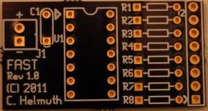

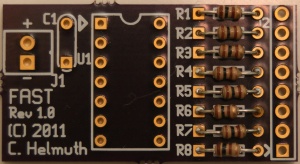

1. Install the eight 51 ohm resistors in positions R1-R8.

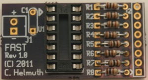

2. Install the 14 pin IC socket so that the notch faces the top of the board like the silkscreen.
3. Install the 0.1uF capacitor in position C1. The capacitor is not polarized, so it can go in either way.

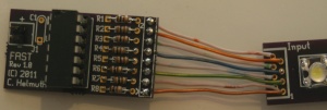

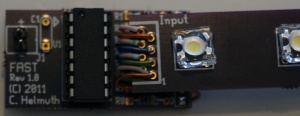

1. Solder the wires from the FAST Controller to the Input of the top LED Segment PCB. The #1 wire on the controller side is near the bottom of the board and has a square hole. It is soldered to the #1 hole of the Input of the top LED Segment pcb, which is marked by the number 1. The holes on the LED Segment board are offset into two rows. The rows are odd and even. So the #2 wire from the FAST Controller goes into the first hole in second row slightly above and to the left of where you soldered in the first wire. The #3 wire goes in the hole directly above the #1 wire. The #4 wire goes above the #2 wire. Continue until you have soldered in all 8 wires.
2. Inspect all of the PCBs to make sure that there are no issues with the soldering.
3. Insert the PIC into the socket on the FAST Controller

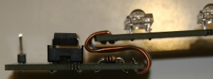

5. The FAST Controller should be placed behind the top LED Segment PCB with some cardboard between the board to prevent them from shorting out. This assembly can then slide into the plastic housing.
