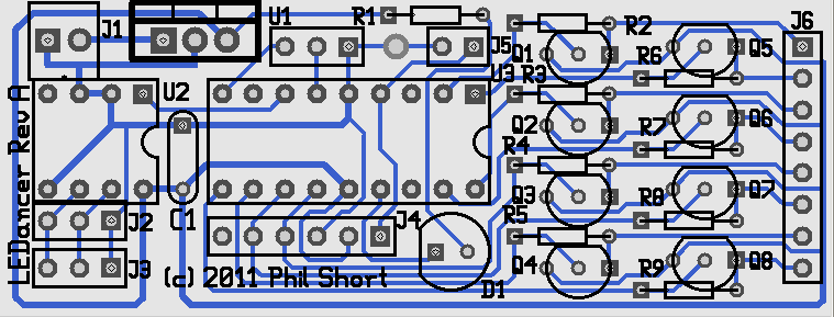

At the moment there isn't a released PCB design.  The design consists of a controller board (with a PIC16F1826 and a ST485 RS485 receiver, a jumper for enabling the DMX Address Program Mode, eight resistors and 8 2N3904 transistors, and some connectors.
Here is a proposed sample PCB design:
Here is a proposed sample PCB design (note that it still needs caps next to the Voltage Regulator):
