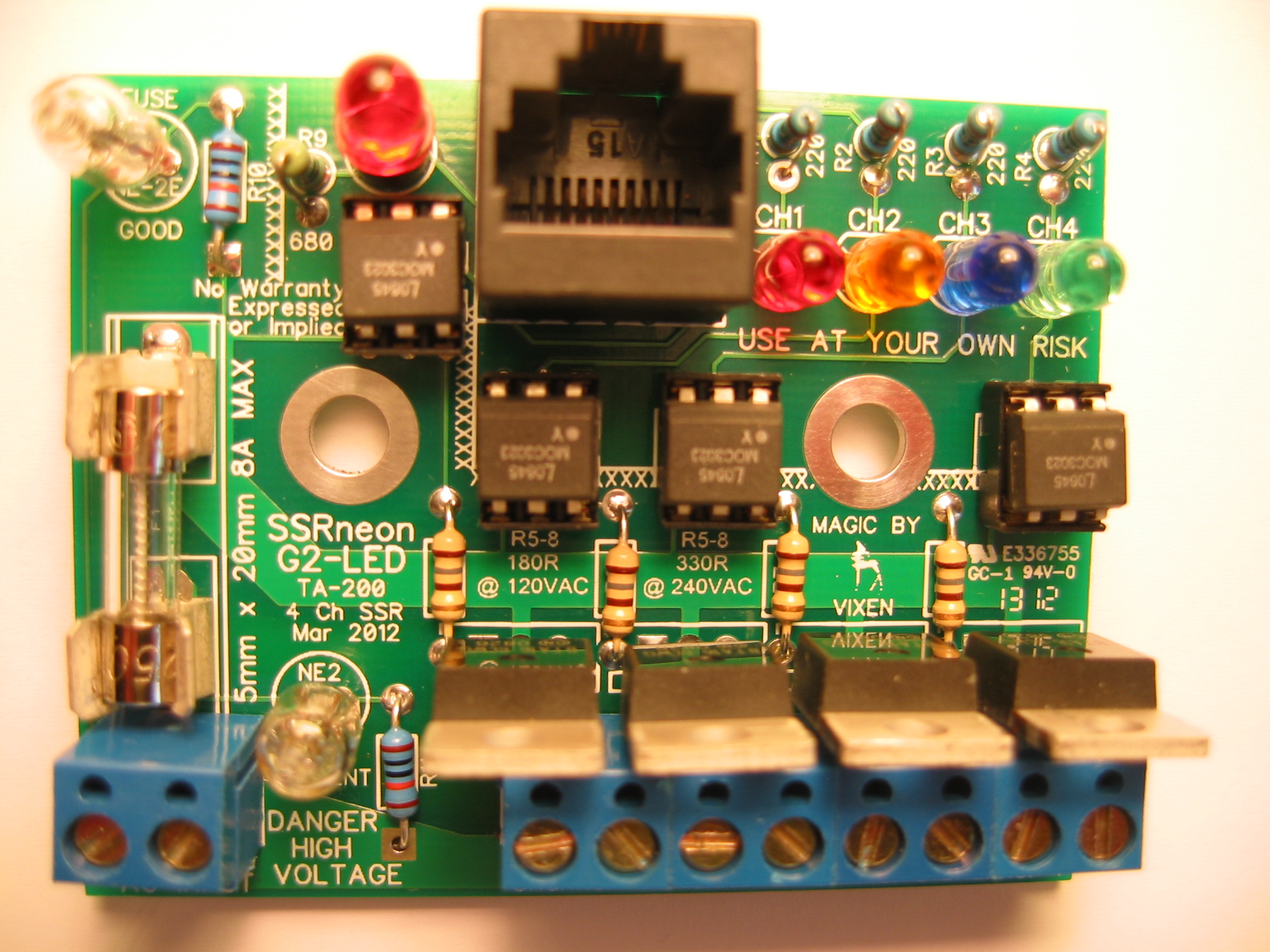

The SSRneon is a 4 port AC Solid State Relay (SSR). It is derived from the same basic design that has been in general use by the DIY community for many years. Most of the DIY SSRs are derived from Sean Bowf's original 4 port SSR. The design has evolved over the years, but the core functions and parts are the same. The SSRneon, SSRoz and SSRez are all such designs.
The SSRneon-G2-LED is a variant of the SSRneon-G2. (ref: SSRneon-G2 wiki entry )
The current Versions of the SSRneon are SSRneon-G2 and SSRneon-G12-LED SSRs.
Safety Features
The main safety feature of any SSR is the main FUSE.
This is discussed in a separate section below.
The SSRneon contains two NE-2E neon light bulbs.
Two key points are what differentiates the SSRneon G2 from the other available SSRs.
1. Dual Neon bulbs that indicate the presence of AC Voltage !
2. The attachment of the AC wires, in AC pairs, along the bottom of the board with NO wirenuts required.
The point of these neon lamps is they serve as a safety warning that AC voltage (which can be lethal) is present on the SSR PCB.
One bulb lights if AC voltage is correctly attached to the board. Marked AC Present on the Boards Silkscreen (legend).
The second bulb lights if AC voltage has successfully passed through the on-board fuse. Marked FUSE OK on the Boards silkscreen (legend).
The presence of the second bulb (FUSE OK) serves as a troubleshooting device. If the AC Present bulb is lit, but the FUSE OK is not, then you know that AC is connected properly, but there is something wrong with the fuse.
Neons are used instead of an incandescent blub due to the fact that a neon bulb is very long lived and is much 'tougher' then an incandescent since there is no filament to break.
These bulbs play no role in the basic function of the relay and can be left off the board. If this is done, the two 100K resistors can also be left off the board. The 100K resistors are needed to keep the bulbs from burning out over time.
General Features
The SSRneon-G2-LED has two key features not present in the SSRneon-G2:
1. The 2 ounce copper AC traces are mirrored on both sides of the board. This allows for greater current carrying capacity. (8 amps)
2. There are LED channel indicators. These LEDs will flash and dim in the same manner as the lights that are hooked to the SSR.
The board has solder pads on both sides of the board and the holes are through plated. This makes for easy and more error free soldering.
The board has 2 ounce copper traces for added reserve capacity and heat absorption.
The SSRneon is designed to mount in the TA-200 enclosure. This enclosure is a proven performer.
The SSRneon fits in the TA-200 Telephone Demarc Enclosure from www.afltele.com.
It is available from Chris Foley's DIY Christmas site:WLC Ventures
All wires attach via terminal blocks. The attachment points are along the bottom of the board facing the enclosure openings. The wire attachment is different then the other SSRs. Instead of grouping all of the neutrals and all of the 'hots' together, each individual wire 'pair' is terminated on their own terminal block. This avoids the problem of having to cut the hot and neutral wire within a pair to different lengths in order to get them to fit nicely inside the already cramped enclosure. The PCB takes care of tying all of the neutrals together for you.
A heatsink can be fashioned and attached to the TRIACs. Use of a heatsink should boost the continuous amp capacity from 4 amps to 7 amps. A heatsink should not be necessary unless the load for any single channel (Tirac) exceeds 1 amp. These are usually made from a piece of aluminum since it cuts and drills easily and absorbs heat rapidly. See the example to the right of a couple dozen homemade headsinks. One safety note about heatsinks. You need to be sure the TRIACs you are using have what is know as an 'isolated tab.' The tab is the exposed metal pad with the hole in it. On some TRIACs the tab is 'hot' or has AC voltage present. You should not use a heatsink that connects all of the TRIACS together unless all the TRIACs have an 'isolated tab'. The TRIAC listed in the BOM has an 'isolated tab' so it is suitable for use with a heatsink.
The board has two points to mount it to the TA-200 enclosure. Great pains were taken to make sure that the screws that come with the enclosure can be used once they have been cut down to a proper length. You can use the screws that come with the enclosure provided you cut them off. The correct length of the cut off shaft BELOW the head is 5/8".
The screws that come with the enclosure are nice in that they have both a hex head and a screw driver slot for installation/removal. (Plus they are free with the enclosure!)

Here is a picture of a completed SSRneon-G2:
