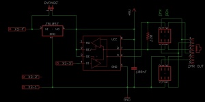

===Schematic===
===Schematic===
The schematic is quite simple and contains few parts. It can be made quite cheaply by replacing certain jumpers, etc with wires. The output jumper layout to support both Renard or DMX wiring schemes was taken from member RPM's E1.31-Renard/DMX bridge. Setting all of the jumpers one way uses the pseudo standard RJ45 DMX format with D+/D- on 1/2 and ground on 7. Setting all the jumpers the other way selects Renard format with D+/D- on 4/5 and ground on 1/2. Note that in both cases, it is still DMX output - this just saves you from making a special cable so that straight Cat5 patch cables can be used. The board includes an optional 78L05 voltage regulator that can be used if you exclusively use 12v pixels. This will convert the voltage to 5v for the RS485 chip but can be bypassed if you have 5v pixels.

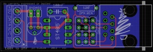

===Board Layout===
===Board Layout===

Schematic
E68X-DMX Schematic
E68X-DMX Schematic
Board Layout
The board layout is very straight forward with a pixel connector and reguator (optional) at one end, an RS-485 chip in the middle and an output jumper setup with RJ45 to DMX connector at the end. Two methods of connections to the E68x are possible. The first consists of a standard 4-contact terminal block that can be wired back to the removable block that plugs into the E68x. The other method consists of running a 20 gauge or so wires down from the board and terminating them directly into a removable block that can be plugged directly into the E68x. This latter method saves on the terminal block and keeps the setup quite neat. Only 3 wires are used (+5v, Ground, Data) but a 4-wire connector was used so it would physically match up to the connector (1.5mm pitch) on the E68x.
