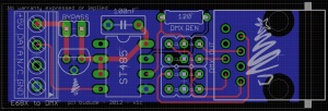

Board Layout
The board layout is very straight forward with a pixel connector and reguator (optional) at one end, an RS-485 chip in the middle and an output jumper setup with RJ45 to DMX connector at the end. Two methods of connections to the E68x are possible. The first consists of a standard 4-contact terminal block that can be wired back to the removable block that plugs into the E68x. The other method consists of running a 20 gauge or so wires down from the board and terminating them directly into a removable block that can be plugged directly into the E68x. This latter method saves on the terminal block and keeps the setup quite neat. Only 3 wires are used (+5v, Ground, Data) but a 4-wire connector was used so it would physically match up to the connector (1.5mm pitch) on the E68x.

Converter Configuration
The only thing to configure on the board are the 4 Renard/DMX jumpers. The four jumpers must be placed all on the left for DMX wiring or all on the right for Renard wiring. You must install all four of the jumpers or install wire jumpers instead for the converter to work properly.
