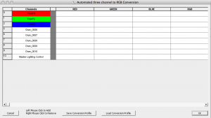

*Open the Converter for RGB (Click Manage Channels -> Auto Convert Channels to RGB. (See Figure)

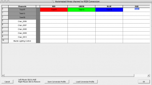

[[File:HLS_AutoConvertRGB_11V.png|thumb|Figure 3-26]]
*Open the Converter for RGB (Click Manage Channels -> Auto Convert Channels to RGB. (See Figure 3-26)
*Locate the three channels you wish to convert.
*To move channels, Left-Click in the channel list, then Left-Click in the RGB section you want to move the channel.  It will become "grayed out" when it has been moved and cannot be selected.
*Place the Red Channel in Red, Green Channel in Green, and Blue Channel in Blue. (See Figure)
[[File:HLS_AutoConvertRGB2_11V.png|thumb|Figure 3-27]]
*Place the Red Channel in Red, Green Channel in Green, and Blue Channel in Blue. (See Figure 3-27)
*Click into the RGB column to name your newly created RGB Channel.
*'''Note:''' If you make a mistake, right-click the channel to move it back to the Channel list.

  • Open the Converter for RGB (Click Manage Channels -> Auto Convert Channels to RGB. (See Figure 3-26)
  • Locate the three channels you wish to convert.
  • To move channels, Left-Click in the channel list, then Left-Click in the RGB section you want to move the channel. It will become "grayed out" when it has been moved and cannot be selected.
Figure 3-27
  • Place the Red Channel in Red, Green Channel in Green, and Blue Channel in Blue. (See Figure 3-27)
  • Click into the RGB column to name your newly created RGB Channel.
  • Note: If you make a mistake, right-click the channel to move it back to the Channel list.
