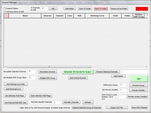

Adding Basic HLS Channels
The Channel Manager screen will now as appear (see Figure 3-3). This is where we will add and configure HLS channels.
  • HLS Channels are not the same as channels on a controller. HLS channels can represent a strand of incandescents or LED's, a "super string" of 3 light colors connected to the same object, a dumb RGB item, a single pixel, or a plane of pixels. This versatility is one of the features that sets HLS apart from some other sequencers.
  • Output channels are actual channel assignments on controllers. Those are handled by HLS when you renumber channels for output.
To add channels:
  1. In the # of Channels to Add field, type the numeric value of number of channels to add.
  2. Click the Add button to create the channels.
Figure 3-3
