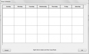

*Click ''Output -> Create/Modify Show Schedule'' | [[File:HLS_Schedule_ShowSchedule.png|thumb|Figure 9-18]] | ||
*Click ''Output -> Create/Modify Show Schedule'' (see Figure 9-18). | |||
*Left-click on a blank space for the day you wish to schedule. | *Left-click on a blank space for the day you wish to schedule. | ||

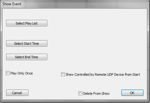

*The Show Event window will open (see Figure 9-19). | |||
*''Select Playlist'' and choose desired playlist from list and click ok. | *''Select Playlist'' and choose desired playlist from list and click ok. | ||

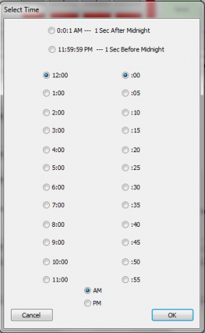

*Click Select Start/End Time (see Figure 9-20). | |||
*Select any additional options, then click ok. | *Select any additional options, then click ok. | ||

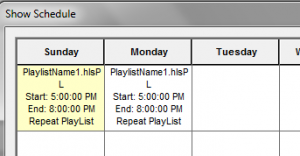

[[File:HLS_Schedule_ShowScheduleCopy.png|thumb|Figure 9-21]] | |||
*To copy a configured show from one day to another, right click on the cell you wish to copy. | *To copy a configured show from one day to another, right click on the cell you wish to copy. | ||
*The selected cell will turn "yellow". | *The selected cell will turn "yellow". | ||
*Right-click in the new cell that you want to copy the show into. | *Right-click in the new cell that you want to copy the show into. | ||
*The copied show will now be in the new cell. | |||

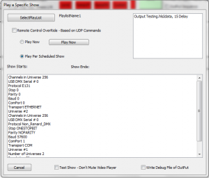

*Click ''Output -> Play Show Schedule''. | *Click ''Output -> Play Show Schedule''. | ||
*Select the playlist you wish to play. | *Select the playlist you wish to play. | ||
*Ensure ''Play per Scheduled Show'' radio button is selected. | *Ensure ''Play per Scheduled Show'' radio button is selected. | ||

- Click Output -> Create/Modify Show Schedule (see Figure 9-18).
- Left-click on a blank space for the day you wish to schedule.
- The Show Event window will open (see Figure 9-19).
- Select Playlist and choose desired playlist from list and click ok.
- Click Select Start/End Time (see Figure 9-20).
- Select any additional options, then click ok.

- To copy a configured show from one day to another, right click on the cell you wish to copy.
- The selected cell will turn "yellow".
- Right-click in the new cell that you want to copy the show into.
- The copied show will now be in the new cell.

- Left-click on the cell with the schedule you wish to delete or modify.
- This opens the Show Event window (see Figure 9-19). From here, you can make any changes you need.
- To Delete from that selected cell, check the Delete from Show button and click ok.

- Click Output -> Play Show Schedule.
- Select the playlist you wish to play.
- Ensure Play per Scheduled Show radio button is selected.
