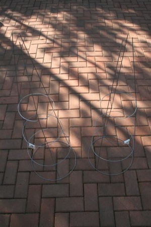

Lets start building! First we will need to decide on the size of the mini tree. I like to use the 2nd largest ring of the cage as the base of the tree. So just flip the cage upside down, step back and take a look at the overall shape. Decide how large or small of a tree you would like.
I used a 24 inch tree so I had to cut down the cage to size. I cut off the bottom ring and used the 2nd largest ring as a standard and cut the next smallest ring in the center of each section between the vertical supports with the bolt cutters. I cut the smallest ring off completely. This will leave you with 3 horizontal section from the middle ring. For the cage that will go over this one you will need to cut all the rings off completely except for the bottom one.
Now you need to decide the height of the tree. If you want a 24" tree mark the vertical supports at 24" and 26". Make a small bend at the 24" mark so when the supports are pulled together them will line up nice and straight.
Now cut them with the bolt cutters at the 26" mark.
Now stack the cage with only the lowest ring on top of the cage with 2 rings.
