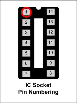

- Momentarily connect a jumper (small piece of wire) between U6 IC socket pin 13 and pin 14
- HB LED should light
- Momentarily connect a jumper between U6 IC socket pin 10 and pin 14
- ZC LED should light
- Momentarily connect a jumper between U6 IC socket pin 9 and pin 14
- SD LED should light
- Momentarily connect a jumper between U6 IC socket pin 8 and pin 14
- FE LED should light
- Momentarily connect a jumper between U6 IC socket pin 7 and pin 14
- OE LED should light
- If all the LEDs in steps 6 thru 10 did light, then the diagnostic LEDs are operational.

- Check for 5.0 VDC at U6 IC socket pin 1
- If incorrect, check the solder pads and/or go back to Troubleshooting Power Problems
- Check for 5.0 VDC on the pins (on underside of board) of resistor network RN1
- If correct, then probably all the LEDs are installed backwards
- If incorrect, check to make sure the shunt (jumper) is good
- If any (but not all) of the LEDs in steps 6 thru 10 did not light, measure the DC voltage at the appropriate location on the IC socket for U6. The voltage measured at each location should be approximately 3.0-3.5 VDC.
Diagnostic LED Measure DC voltage at HB U6 IC socket pin 13 ZC U6 IC socket pin 10 SD U6 IC socket pin 9 FE U6 IC socket pin 8 OE U6 IC socket pin 7
- If any voltage measured in step 13 was 0 VDC, then most probably the associated LED is installed backwards.
- If any voltage measured in step 13 was 5 VDC, then most probably the solder pads for the associated LED are bridged.
