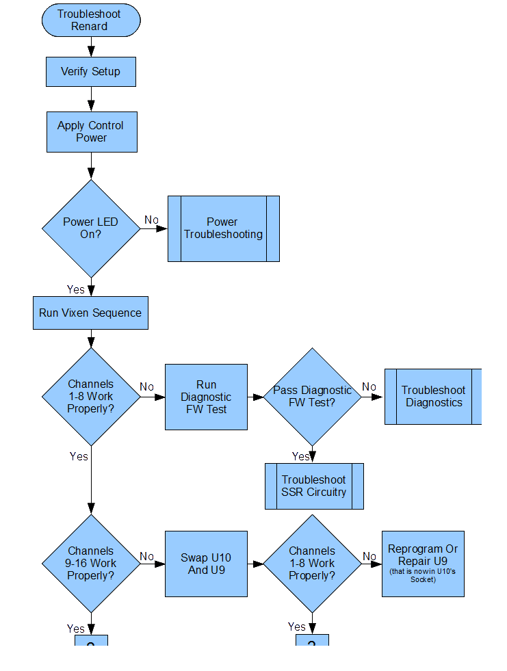

Troubleshooting the Renard 64XC Controller
Troubleshooting Flow
Troubleshooting Steps
- Verify that you have the power/control cables connected correctly as compared to the Renard 64XC Controller wiki.
- Verify that you have the Vixen plug-in settings correct as compared to the Renard 64XC Controller wiki.
- For the following steps, the PICs (U7 thru U14) need to be programmed with the Renard Operational Firmware.
- Turn ON AC power
- PWR LED should be lit
- If incorrect , then go to Troubleshooting Power Problems.
- Run a Vixen sequence
- Do Channels 1 thru 8 respond as programmed in the Vixen sequence?
- If they don't, then go to Troubleshooting Diagnostics Problems.
- If the diagnostic routine passed, then go to Troubleshooting SSR Circuitry Problems.
- Do Channels 9 thru 16 respond as programmed in the Vixen sequence?
- If they do, go to step 15
- Turn OFF AC power
- Swap PIC chips U10 and U9
- Turn ON AC power
- Run the Vixen sequence again
- If they don't, reprogram or replace the U9 PIC chip that you moved to the U10 socket and retest
- If they don’t, then go to Troubleshooting SSR Circuitry Problems.
- Do Channels 17 thru 24 respond as programmed in the Vixen sequence?
- If they do, then goto step XX.
- Turn OFF AC power
- Swap PIC chips U10 and U8
- Turn ON AC power
- If they don't, reprogram or replace the U8 PIC chip that you moved to the U10 socket and retest
- If they don’t, replace PIC chip U6 and retest
- If they do, then your Renard SS24 Controller board is operational
Symptom(s):
- Channel remains on constantly
- Channel does not come on when commanded
- Triac gate resistor burnt/blown
Possible Problem(s):
- Bad triac
- Bad opto
- Bad/missed solder joints
![](/wiki/images/thumb/5/5f/Wiki_-_TSG_Renard_SS24_SSR_Circuits_troubleshooting_tree.gif/592px-Wiki_-_TSG_Renard_SS24_SSR_Circuits_troubleshooting_tree.gif)
