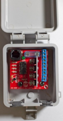

TA-200 (Terminal Access TA-200 Terminal Enclosure)
TA-200TA-200TA-200 Ukewarrior SSRez g2ktcf SSRNeon Ukewarrior DCSSR dlovely
Common usage: SSRez ACSSR, SSRNeon ACSSR, DCSSR Version 2.4
External Dimensions (HxWxD): 3.13” x 3.63” x 2.5” (7.95cm x 9.22cm x 6.35cm)

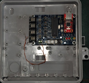

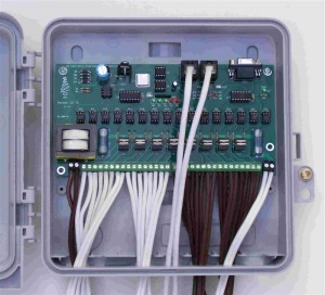

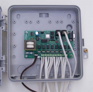

CG-1000 (CableGuard 1000 Coax Demarcation Enclosure
CG-1000 CG-1000E681 + Power Supply tjetzer REN64 g2ktcf SS16 WayneJ SS8 WayneJ REN24HC jrd REN48LSD jklingert
Common usage: Renard SS8 AC Controller, Renard SS16 AC Controller, Ren24HC AC Controller, Renard 48LSD DC Controller, Ren64 Controller
External Dimensions (HxWxD): 9.00" x 9.00" x 3.00" (22.80cm x 22.80cm x 7.60cm)
Internal Dimensions:
Datasheet
Internal Drawing

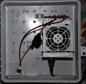

CG-1500 (CableGuard 1500 Coax Demarcation Enclosure)
CG-1500CG-1500 REN48LSD + Power Supply Mangrove REN48LSD + Power Supply OregonLights PC Power Supply (old CG-1500 hole pattern) jklingert Ren48LSD + Power Supply + Breakout Boards rfallatt Ren48LSD + Power Supply + Breakout Boards rfallatt
Common usage: Similar to CG-1000, but box is larger. E680, E681, E682 Pixel Controllers, Various Power Supplies
External Dimensions (HxWxD): 12.25" x 12" x 5.25" (31.10cm x 30.50cm x 13.30cm)
Datasheet
Internal Drawing

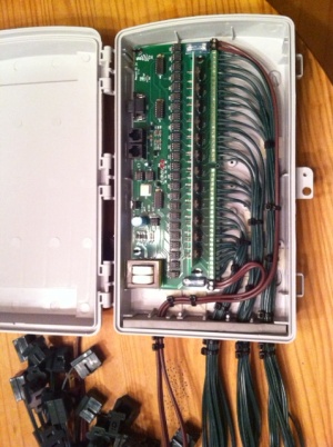

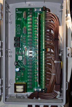

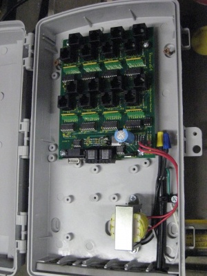

CG-2000 (CableGuard 2000 Coax Demarcation Enclosure)
CG-2000 CG-2000 Renard SS24 rjchu Renard SS24 waynej Ren64 JEEPGUY
Common usage: Renard SS 24
External Dimensions (HxWxD): 13.0" x 9.0" x 3.0" (33.00cm x 22.80cm x 7.60cm)
Datasheet
Internal Drawing

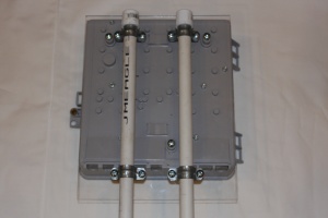

Mounting Options
BillinSoFl somtng4u2c Mangrove
