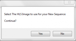

- Open HLS and click File -> Start NEW Sequence USING a SAVED Image.
- HLS will prompt you to verify you want to use a saved image. (Click yes). See Figure 11-1.

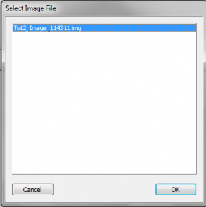

- HLS will then open a window with all previously saved Images for you to choose from. See Figure 11-2.
- Select the image you wish to use, and click OK.

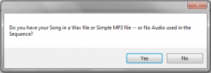

- HLS will then ask if you want to use an audio file (YES for audio, NO for a sequence of no audio). See Figure 11-3.
