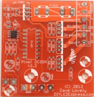

The Pixel DCSSR Version 1.3 is a simple device to assemble and test. It is easiest if you build the units by inserting the various components from smallest to tallest .
- Begin by inspecting the PCBs to look for any defects such as cracks or breaks. The holes on the board should be open on both sides. Then inspect and sort out the various parts for the board.
- Install the resistors:
- four 470 ohm resistors (yellow-violet-brown) in positions R1-R3 in the center of the board. The resistors are not polarized so they can go either way.
- four 10K ohm resistors (brown-black-orange) in positions R4-R6 in the center of the board. The resistors are not polarized so they can go either way.
- two 33 ohm resistors (*) in positions R7-R8 on the left center of the board. The resistors are not polarized so they can go either way.
- two 1K ohm resistors (brown-black-red) in positions R9-R10 on the bottom left and bottom right of the board. The resistors are not polarized so they can go either way.
- one 100 ohm resistors (*) in positions R11 on the left center of the board. The resistors are not polarized so they can go either way.
- Install the two 0.1 uF capacitors in positions C1-C2 on the bottom left of the board. The capacitors are not polarized so they can go either way.
- Install the Install the 16 pin socket in the center of the board. Note that the notch faces the top of the board matching the silkscreen pattern on the PCB.
- Install the light emitting diodes:
- Install the Green LED in the position marked Signal near the bottom left of the board. Note that the LED is polarized and long lead should go towards the bottom of the board. (Note: silkscreen shows "FLAT" side of the LED, this can also be used to check for proper orientation)
- Insert the Red LED in the position marked Power near the bottom center of the board. Note that the LED is polarized and the long lead should face towards the top of the board.
- Install the 5v linear regulator on the top left side of the board. Note that there are two sets of three holes. If you are using the small TO-92 package regulator listed in the BOM then the 7805 will use the holes closest to the caps. Note the regulator is polarized and the flat side should face left to match the orientation on the silkscreen. NOTE: IF YOU PLAN TO USE 5VDC LOADS, SEE THE DESIGN OPTIONS SECTION BELOW BEFORE INSTALLING THE VOLTAGE REGULATOR.
- Install the two fuse clips near the top center of the circuit board. It may be easier to put the fuse in then install them on the PCB to ensure they are installed in the correct direction and line up. Please note that fuse clips may be polarized. Examine them carefully, as they often have extra bends that should be placed on the outside end, to stop the fuse from slipping out. Be careful, the fuse holders require a fair amount of solder and heat to attach them. The FUSE should not be present when installing the clips, as the extra heat may melt the end of the fuse.
- Connect the three 2 position screw terminal strips together by sliding the notches on the sides together. Next solder them to the circuit board with the wire opening side facing the right side of the board.
- Install the 3 MOSFETs in the center of the board. It may be easier to attach them to the heat sink first using heatsink compound and screws and nuts, then soldering them to the PCB so they line up correctly. The MOSFETs are polarized and they should be installed with the tab facing the screw terminals.
- Install the pigtails to the bottom left of the board.
- Install the fuse in the clips if it is not already there.
- Gently install the Optoisolator in the socket making sure that the notch faces the top of the board , matching the silkscreen drawing.
- Inspect the board to look for any missing solder joints, solder bridges or cold solder joints.

Connect power to the DC IN terminals and the POWER LED should light.
Connect the Pixel DCSSR Version 1.3 to a Pixel controller running 5VDC. The SIGNAL LED should light.
