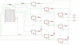

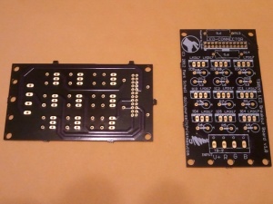

TIR LED Breakout Board
A TIR Breakout Board has been designed and is being sold in a TIR Breakout Board Group Buy. This board allows you to power the LED boards directly with a 24vdc power source. To protect the LEDs from burning out, it is necessary to independently provide a constant current source to each of the 9 LED arrays. This design provides the ability to drive 9 LED arrays with 3 inputs. The design makes use of a LM317 configured to provide a constant 0.3A per LED Array using a circuit like this.
Breakout Board BOM
Part Number | Description | Quantity |
538-87831-2420 | Headers & Wire Housings 2MM HDR. 24 CKT. Vert. SMT | 1 |
511-LM317T | Linear Regulators - Standard 1.2-37V Adj Positive 1.5 Amp Output | 9 |
TBD | 4.3 Ω 1/2W Resistor | 9 |
TBD | 5.6 Ω 1 W Resistor | 2 |
TBD | 13 Ω 2 W Resistor | 2 |
TBD | 16 Ω 2 W Resistor | 1 |
Breakout Board Schematic
