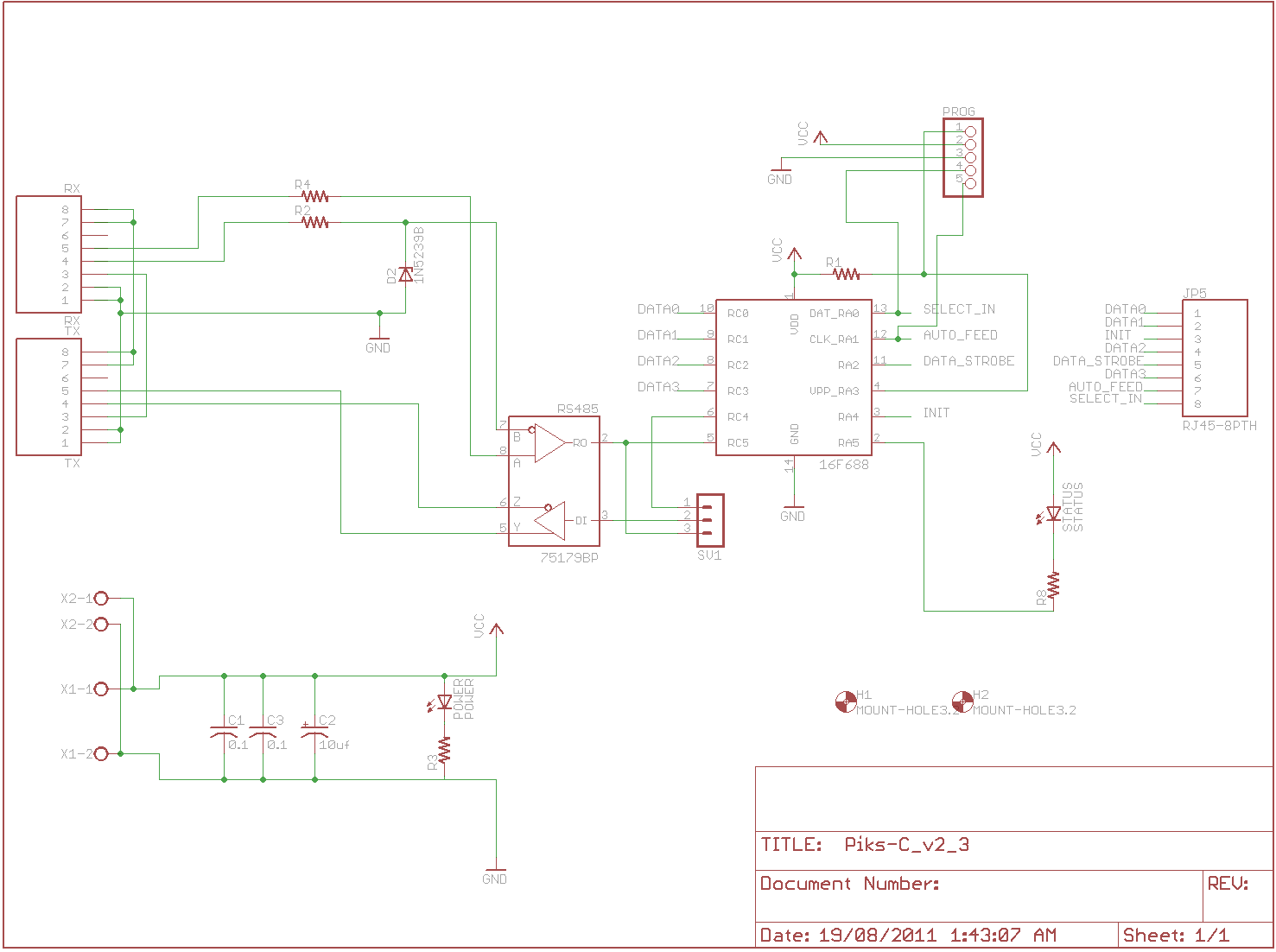

Schematic

Note: Markings on the PCB SN75176BP are WRONG. The correct part is SN75179BP. This is listed correctly in the visual BOM above, and in the Mouser project.

Known Issues (PIX-C 2.2)
The serial re-transmit on the PIX-C 2.2 does not work properly. This results in corrupted image "downstream" of the first PIX-C. A simple hardware solution exists. Cut the trace coming FROM pin 6 of the PIC 16F688, and then jumper pins 2 & 3 of the SN75179BP. This will cause all incoming bits to be echoed as outgoing traffic. Version 2.3 of the PIX-C introduced a jumper that can be used to do this modification, rather than cutting traces on the board.
