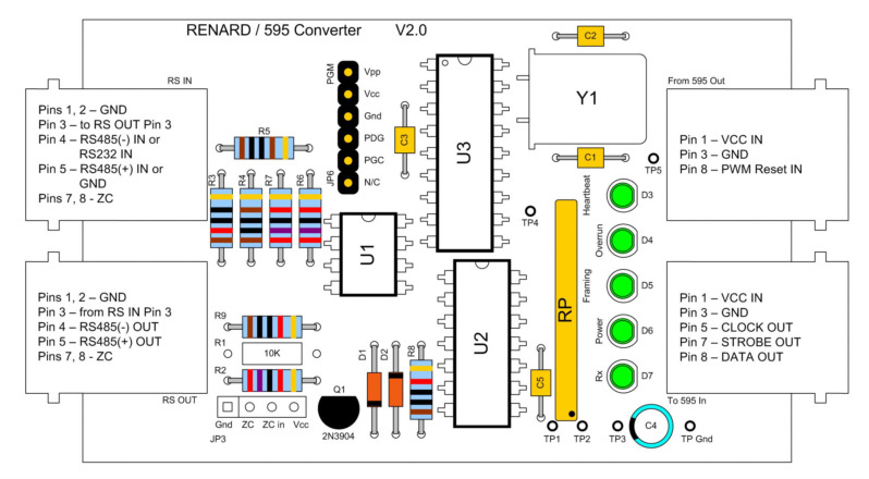

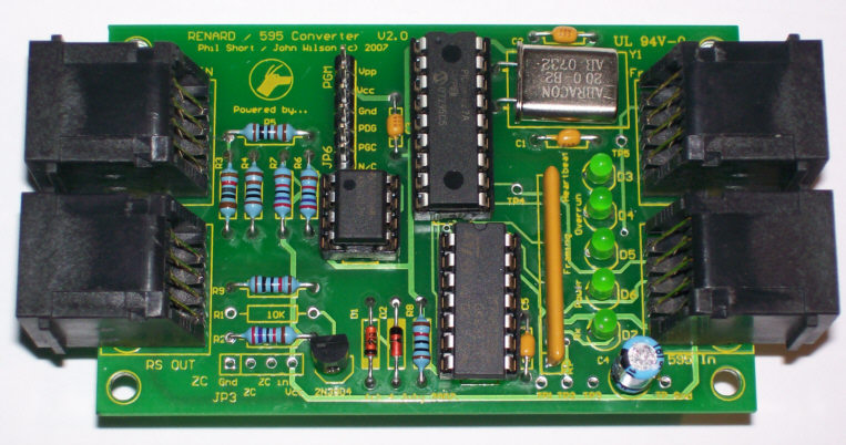

Connectors
- To 595 In (JP1) – Provides the Data, Clock and Strobe signals to the 595/GRINCH controller. Also, provides the Ren-C an operating voltage from the 595/GRINCH controller.
- From 595 Out (JP2) – Brings the output of the shift-register on the 595/GRINCH board back to the Ren-C to enable PWM operation. This cable can be omitted if PWM operation is not needed/desired.
- RS IN (JP4) – RS232/RS485 incoming data and ZC signals from an up-stream controller board or controlling PC.
- RS OUT (JP5) – RS232/RS485 outgoing data and ZC signals for downstream controller boards.
IC Chips
- U1 – RS232/RS485 Receiver/Transmitter
- U2 – Quad NOR gate
- U3 – PIC16F627A Microcontroller (the brain of the Ren-C)
Diagnostic LEDs
- D3 Heartbeat – Blinks on/off at the rate of the ZC signal
- D4 Overrun – Indicates an data overrun error in the usart of the PIC
- D5 Framing – Indicates a data framing error in the usart of the PIC
- D6 Power – Lit whenever power is applied to the board
- D7 Rx – Lit whenever RS232/RS485 data is received by the PIC
Headers
- JP3 – 4-pin connector that provides an alternate method for bringing the ZC signal and operating voltage (5 VDC) onto the board.
- JP6 - 6-pin connector that can be used to program the PIC in-circuit with either a PicKit2 Programmer (DV164120 or PG164120) or the bare programmer from PicKit1 (PG164101).
Test Points
- TP1 – Clock Out
- TP2, TP5 – PWM Reset In
- TP3 – Data Out
- TP4 – Strobe Out

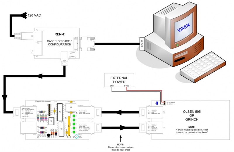

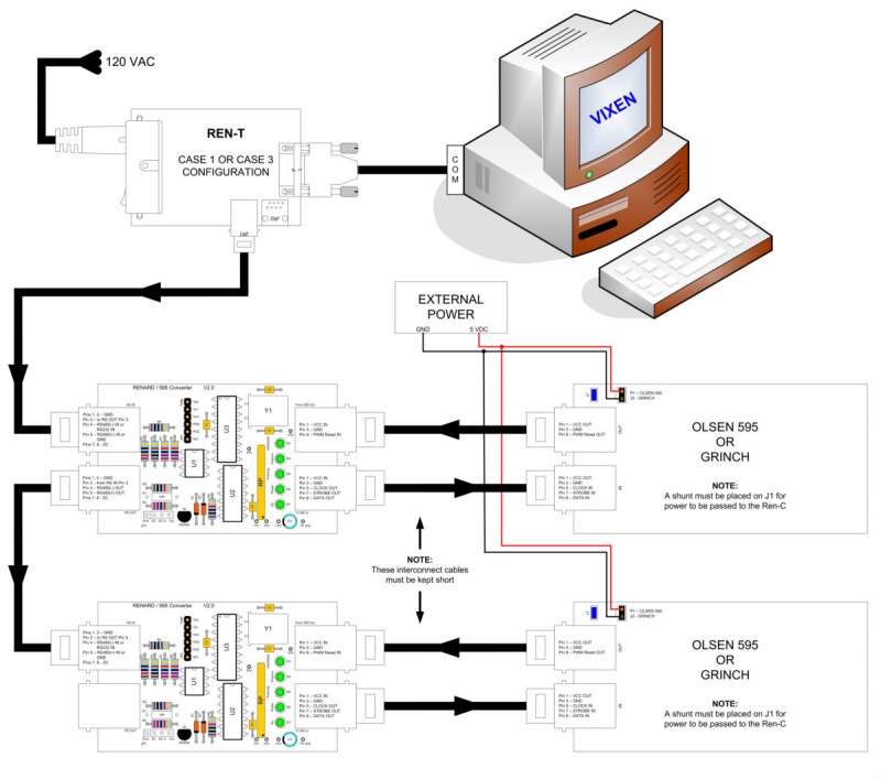

- Some of the signals on the Ren-C are fairly high-speed (2.5 MHz), so the cables between the Ren-C board and the 595/GRINCH controller should be as short as possible. Cable length should not exceed 6".
Typical Single Ren-C Connection
Typical Multiple Ren-C Connection

The Ren-C requires an external power source to operate. This power source must be regulated/filtered 5 VDC. There are two possible methods of applying power to the Ren-C.
Power Connections
- Option 1 [Preferred Method]
- The Ren-C can get it’s operating voltage from the COOP OLSEN 595 or GRINCH controller board that it is connected to. With this option the COOP OLSEN 595 or GRINCH controller board would be connected directly to the external 5 VDC power supply at either P1 or J2 respectfully. By placing a shunt on J1, this would allow the 5 VDC to be passed to the Ren-C via the RJ45 IN/OUT connectors on pin 1.
- Option 2
- The Ren-C can be powered directly by an external 5 VDC power supply. This can be accomplished by connecting 5VDC to pin 4 and GND to pin 1 of header JP3. When using this option you should remove the shunt from J1 of the connected COOP OLSEN 595 or GRINCH controller board to prevent any problems with the associated external power sources.

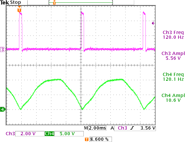

The Zero Crossing (ZC) signal is one of the most difficult signals for new users to understand. Simply put, ZC is the point at which the AC signal crosses zero volts. The ZC point needs to be known so that the triacs can be turned on/off at the correct time to achieve a dimming effect.
One of the factors that adds to confusion is that the ZC signal is actually different at various points in the overall light control process. The output of the Ren-T (green trace in picture below) is commonly referred to as a ZC signal. This raw ZC is not in a suitable form to be used by the PIC. By applying this signal to base of Q1 on the Ren-C, we will get a new ZC signal (purple trace in picture below) that the PIC can use to for the dimming timing.
Now that you understand the ZC signal, you can better decide how you want to get a ZC signal on the Ren-C.
- Option 1
- ZC can be generated on the board, by connecting a 9VDC (unregulated and unfiltered) supply to pins #7,8 of the RS IN RJ45 socket. This input signal (green trace in picture below) is a pulsating signal, rising from 0V to 9V and back in time with the AC power line (100 or 120 times per second, depending on your locale). This signal is the normal output from the Ren-T or it can be created using this circuit.
