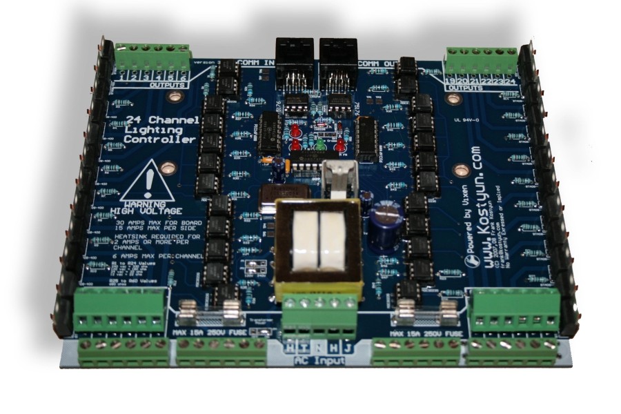

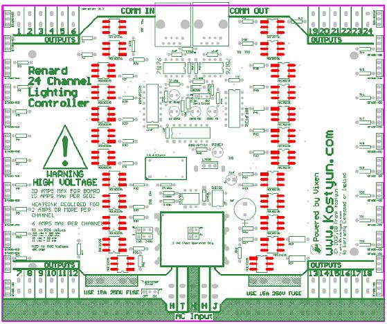

Layout
Renard 24HC PCB

Design Notes for the HC PCB
The COMM FR LED pads are backwards - the cathode (short leg on the LED) will go into the round hole

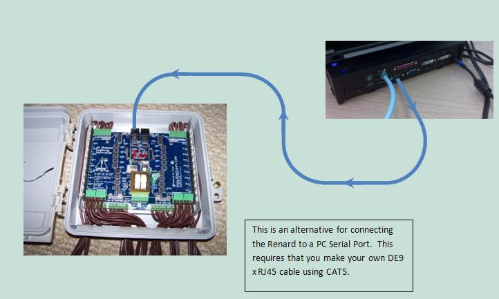

- Data cables for Renard board connection directly to computer COMM port
PC DE9 Pin 3 to Renard 64XC JDP1 Pin 3 PC DE9 Pin 5 to Renard 64XC JDP1 Pin 5
PC DE9 Pin 3 to RJ45-pin 4 PC DE9 Pin 5 to RJ45-pin 5 and pin 1 and/or pin 2
