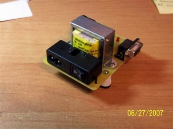

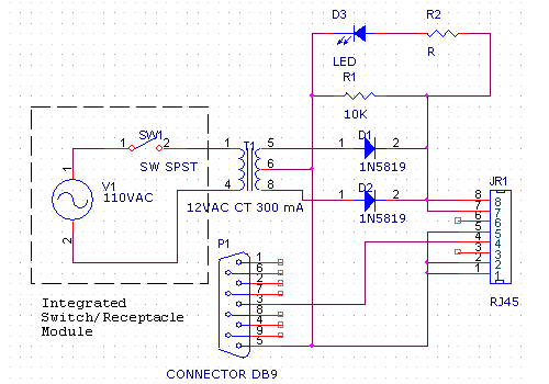

Here is the schematic of a transformer board that may be useful for bring the input (RS232), the zero-crossing signal (and low-voltage power, in some cases) to the Renard controllers. The current rating of the transformer is good for powering perhaps four Renard8 boards (assuming 75 mA each). This transformer board can be used to bring input signals and zero-crossing signals into the Renard64 board and into the Ren-C converter, although some other method must be used supply low-voltage power to the controller (the Renard64 requires 1A when the status LEDs are installed, and the Ren-C board draws power from the 595 board that it is attached to).
The various Renard boards all have several different connection options, and must be configured properly to use this transformer board. You can find the instructions for configuring the Ren-T for different applications here .
Note: the filter cap on the Renard16 board is too small to work with the transformer board at this time. That board must be powered using an externally filtered supply.
Note: the 1N5819 diodes can be replaced with 1N4001 diodes, especially if you are not using this board to provide power to the Renard controller (i.e. you are using it just for the input signal zero-crossing connections.

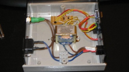

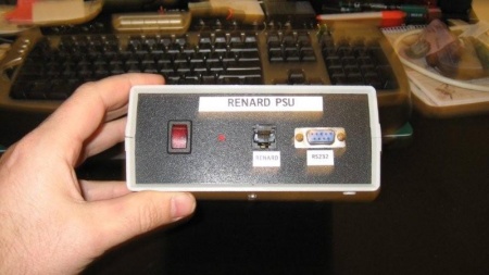

Wjohn's  home made power supply, based on the circuit above.
Inside wjohn's home made power supply, based on the circuit above. The case is an ABS instrument case, and the transformer is mounted using plastic hardware (insulated). The RJ45 is a PCB mount version, that has been 'hot glued' to the front panel. The wiring is kept tidy by using heat shrink tubing around the cable runs. AC is connected to the PSU via the IEC socket on the rear panel. A panel mounted fuse holder is used to keep things safe and an illuminated power switch and DC powered LED provide inidication of status of the PSU on the front panel.

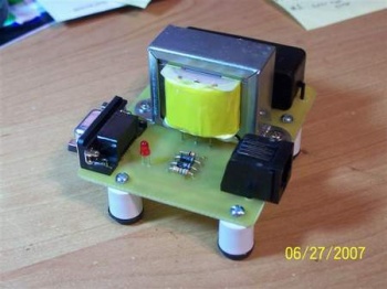

Below is a PCB based version of the power supply. This was the first version constructed by Wayne. Version 2 will include onboard RS-232 to RS-485 conversion, as well as the power supply in Version 1. The Ren-T V2.4 is now being used, and can be seen here
