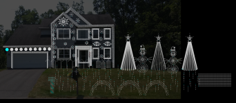

I just set up my xLights 3D view after years of using the 2D viewer. When I first started moving things around in the 3D viewer it messed up my 2D preview, but as I got better at manipulating I was able to get both the 2D and 3D views to look the way I wanted.
I do have to drag and zoom my display view, but everything is working perfectly between the two versions.
