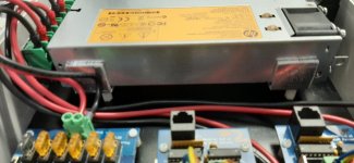

This is how I mount all my psu's. I bend a 1" or so wide piece of aluminum stock into a U shap. Just snug on psu. Then mount it in the controller box. The psu just snaps in and out of case.
The one in the pic is a 750w in a CG1500. I have a 1200w but is not currently mounted because I'm redoing that box. That one the psu is mounted up on its side, pic of mounts included. I believe that most server psu's are roughly the same size.
This may not be for everybody but it works for me.
