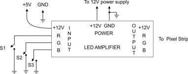

I've read that some have used "RGB amplifiers" as DCSSRs. I'm attempting to do this without too much luck at the moment.
My RGB amp appears to work. If I wire it's output terminals to the 4 wires of a strip. And I apply power to the power terminals. I can then ground any of the color input pins of the RGB amp, I can get the appropriate color of the strip to light up. Now I think I could connect the solid color wires of the cat5 to the RGB input pins and the Orange/white wire to the + terminal. But when I connect this cat5 to one of the outputs on my RP32 I'm not getting anything on the lights. Any ideas where I'm going wrong?
This is the RGB amp I'm using. http://www.aliexpress.com/store/pro...put-4A-3-channel-output/701799_877560440.html
