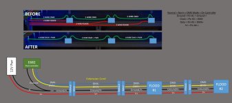

I know this is an older thread, but thought I'd response for people who stumble across this thread looking to add flood lights to their display. I purchased some RGB flood lights from Ray Wu a few years ago. They're DMX controlled, which work fine if you have SanDevices controller. I'm not sure if Falcon controllers handle DMX. Anyway they had one annoying problem, they each had separate DMX and power connectors, which meant I'd need to run both a DMX wire and power wire to each light. I decided to build my own connectors combining the two wires into one. I'm super happy with how it worked out, and it was actually a pretty easy conversion. Now I can daisy chain my flood lights together. This attached diagram explains my alteration.

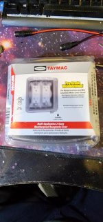

I have been trying to make some Ws2811 Pixel Flood Lights, my main issue was a waterproof case to use outside.
I have not had any luck in finding a product that will house the Control board and have a heatsink for the LED.
So my workaround is this.
The Waterproof case
The Heatsink
The Controller and 10 Watt LED
Not sure how waterproof it's going to be but I will give it a try.
I wish the cover was Clear and not frosted though.
Might have to drill a hole into it and put a lens on the cover?

Looks good - you might need a constant current driver rather than the simple resistor arrangement you have, but the circuitry for those is more complex. BTW I know you are using WS2811 - there are commercially available boards for both 3 and 4 channels (RGB and RGBW). I used these units, and replaced the LED chip with a RGBW version, so essentially just used the case. There was enough room in the rear 'box' for the control board (just)
