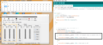

I suspect his this is answered 100 times already in this forum but I cannot seem to find it. I've set up a simple relay running on a wemos d1 mini w/ e.131 code that works to trigger the relay using da_tester but cannot seem to make it work in xlights at all... can anyone help guide me as to what I am doing wrong? I tried adding a DMX controller and single pixel and can't get this relay to fire in xlights.. only from da_tester...
