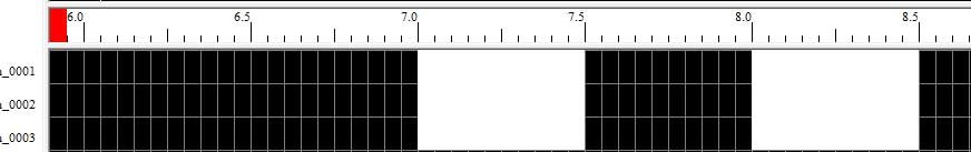

Here's an example that just exhibited the problem. All these entries and changes were in "view background alone".
I had three channels on WHITE for one second, off for one second, and then back on for one second:

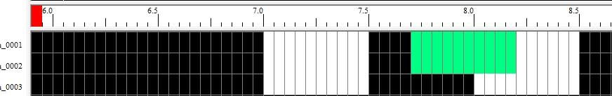

I deleted the second set of WHITE cells and put GREEN cells in their place, but about a half second earlier than the WHITES had been. So now they were ON for one second, off for a half second, and then on (but green) for one second:

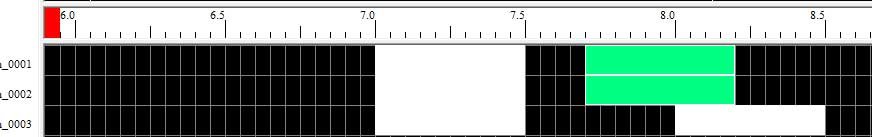

When I went into preview I noticed the white cells that I'd deleted were back, but with the green cells still in place. So in effect it was WHITE on for 1 second, off for a half second, GREEN on for a half second, and then WHITE on for a half second:
When I pressed play, the preview screen showed WHITE/OFF/GREEN/WHITE on the screen.
When I left preview, the screen reverted to the correct (2nd image above) version. A subsequent preview acted the way it was supposed to (WHITE/OFF/GREEN).
