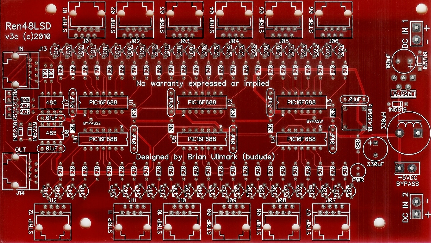

Building the Ren48LSD
The Ren48LSD requires a fair bit of soldering so take your time and ensure you install the components in the correct orientation when required. Start by sorting the components by type and values. Look over the PCB before starting noting the location of the various components. Follow the standard procedure of installing the lowest profile parts first and ending up with the tallest.
- Install the six 10k resistors near each PIC
- Install the two 1k resistors near the 485 chips
- Install the two 27k resistors near the 485 chips
- Install the one 120 resistor near the 485 chips
- Install the one 680 resistor near the LED
- Install the 1N5229 diode near the 485 chips – note the correct orientation
- Install the 1N5239 diode near the 485 chips – note the correct orientation
- Install the 1N5819 diodes near the voltage regulator – note the correct orientation
- Install all forty-eight 470 ohm resistors doing 4-8 at a time.
- Install the nine decoupling capacitors near the IC sockets and oscillator
- Install the six 14-pin PIC chip sockets - note the correct orientation (top 3 go one way, bottom 3 go the other way)
- Install the two 8-pin 485 chip sockets - note the correct orientaiton
- Install the 18.432MHz oscillator – note the squared corner for correct orientation
- Install the 48 transistors – note the correct orientation – the emitter is nearest the PICs, base in the middle and collector near the RJ45 jacks
Note that if you are using a regulated 5vdc power supply for your input, you can omit installing most of the regulator circuitry.
- Install the two 2-pin shunt jumpers (note picture shows only one installed)
- Install the LED – note correct orientation
- Install the DC input terminal blocks – note correct orientation
- Install the +5vdc bypass block (Install for 5vdc input) – note correct orientation
- Install the LM2575 regulator (Do not install for 5vdc input) - note correct orientation
- Install the 100uF/50v capacitor (Do not install for 5vdc input) – note correct orientation
- Install the 330uF/16v capacitor – note correct orientation
- Install the choke coil (Do not install for 5vdc input)
- Install the fourteen RJ45 jacks – note that side-entry jacks can be subsituted
- Mount the 5v regulator heat sink if you installed the regulator – use a small amount of heat sink compound
Congratulations! That completes the construction of the Ren48LSD!
