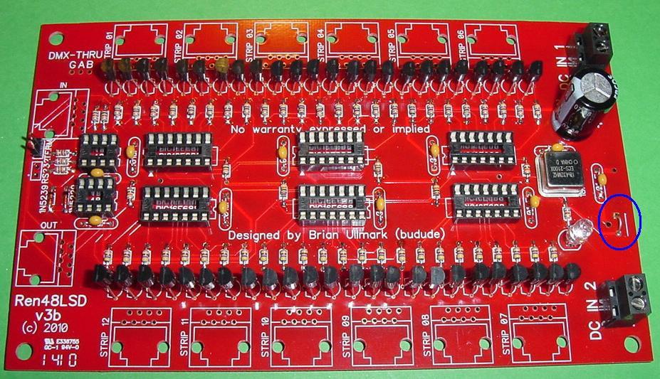

Boards/Kits purchased after Aug 2013 are a new batch that has the correction on pin 7.
PRE Aug 2013 Boards Only -- NOTE -- If you purchased a Ren48LSD board from diyledexpress then you should know that there was a slight mistake on the board files. Pin 7 of ALL the RJ45 outputs is not connected to anything. To use that pin, you must run a small jumper from pin 5 to pin 7 or simply blob up some solder between the two pins. This will ensure the common V+ is distributed properly to all four odd pins on the outputs.
You can tell if you have one of these boards by inspecting the underside of the board

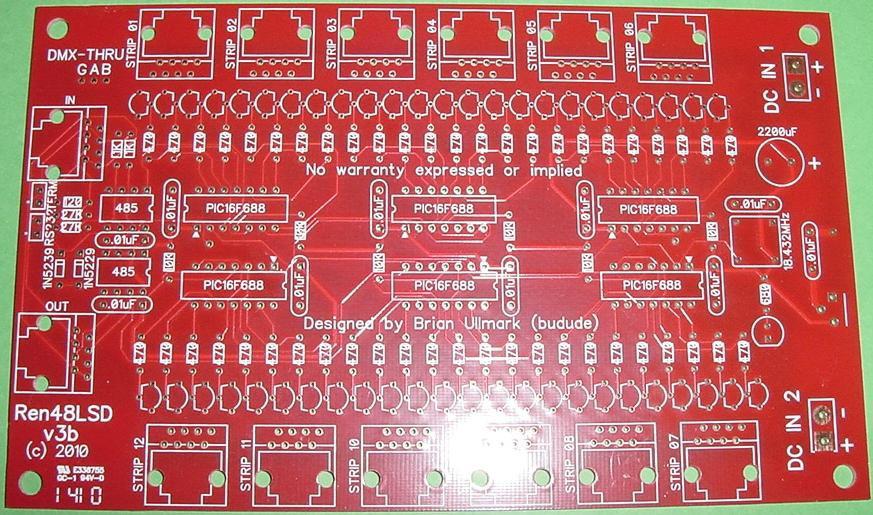

The Ren48LSD requires a fair bit of soldering so take your time and ensure you install the components in the correct orientation when required. Start by sorting the components by type and values. Look over the PCB before starting noting the location of the various components. Follow the standard procedure of installing the lowest profile parts first and ending up with the tallest.

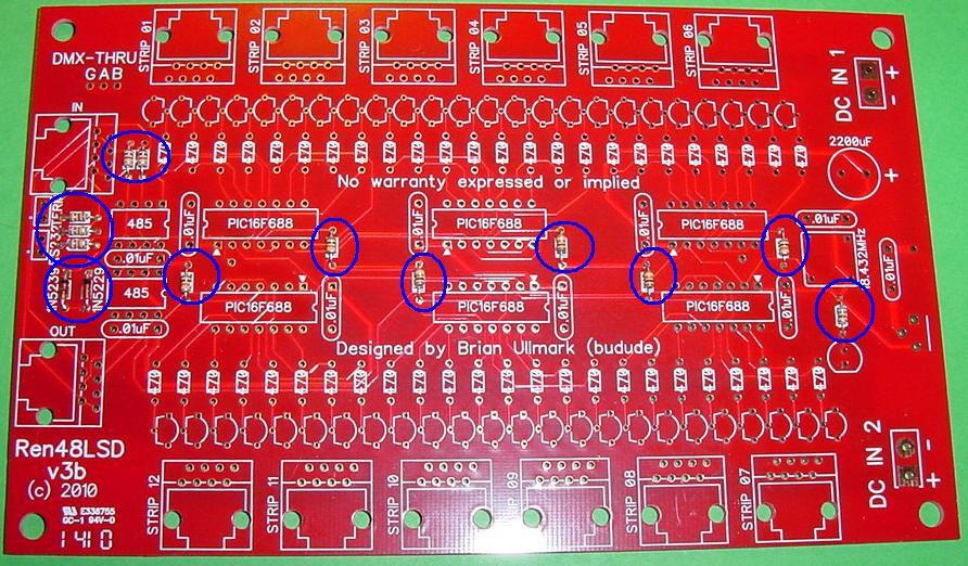

1. Install the six 10k resistors near each PIC
2. Install the two 1k resistors near the 485 chips
3. Install the two 27k resistors near the 485 chips
4. Install the one 120 resistor near the 485 chips
5. Install the one 680 resistor near the LED

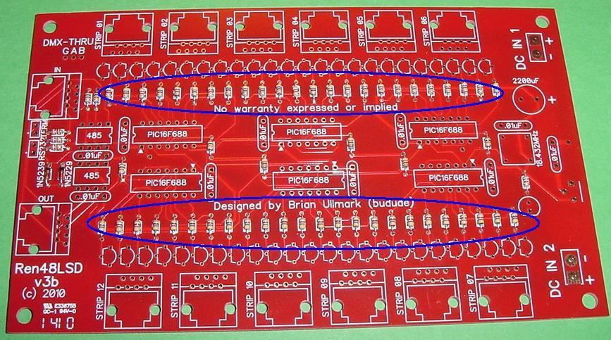

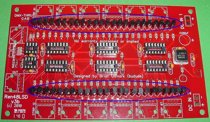

9. Install all forty-eight 470 ohm resistors doing 4-8 at a time.

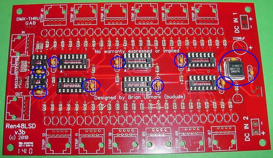

10. Install the nine decoupling capacitors near the IC sockets and oscillator. Note that the silkscreen says ".01uF" - in fact they are 0.1uF (100nF).

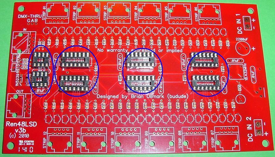

11. Install the six 14-pin PIC chip sockets - note the correct orientation - the top 3 sockets have the notch facing towards the left, and the bottom 3 sockets have the notch facing the right.
12. Install the two 8-pin 485 chip sockets - note the correct orientation - the notch faces to the right side of the board towards the PICs.

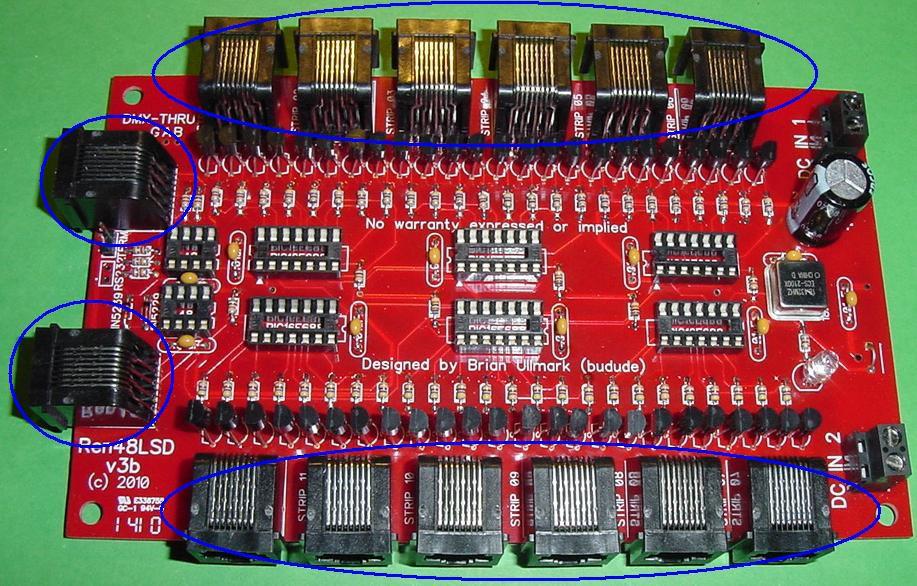

14. Install the 48 transistors – note the correct orientation – the emitter is nearest the PICs, base in the middle and collector near the RJ45 jacks. The legs of the transistors will need to be bent slightly to fit the holes. The middle leg will end up being out in front of the flat side of the transistor.
15. Install the two 2-pin shunt jumpers
16. Install the LED – note correct orientation - the flat side of the LED faces the bottom of the board and the shorter leg goes into the square hole.

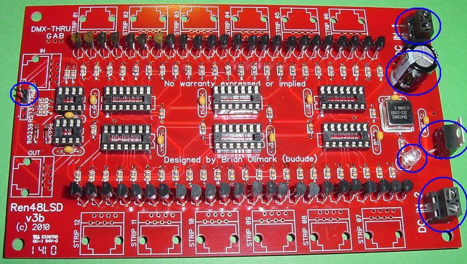

17. Install the DC input terminal blocks – note correct orientation - have the side where the power wires will be inserted facing to the right.
18. Install the +5vdc bypass block (Install for 5vdc input)
Note that if you are using a regulated 5vdc power supply for your input, you should omit installing most of the regulator circuitry.
19. Install the LM2575 regulator (Do not install for 5vdc input) - note correct orientation - pin 1 is denoted by the square pad - the odd number pins are the pins farthest away from the back
20. Install the 100uF/50v capacitor (Do not install for 5vdc input) – note correct orientation - the capacitor has a stripe on the side denoting the negative leg that goes in the round hole.
21. Install the 330uF/16v capacitor – note correct orientation - the capacitor has a stripe on the side denoting the negative leg that goes in the round hole.
22. Mount the 5v regulator heat sink if you installed the regulator – use a small amount of heat sink compound
23. Install the choke coil - there is no polarity, it can be installed in either direction (Do not install for 5vdc input)
24. Install the fourteen RJ45 jacks – note that side-entry jacks can be substituted

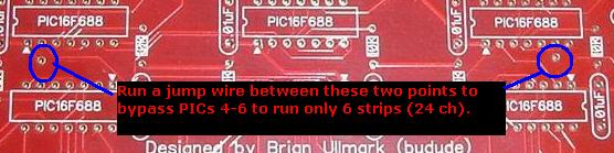

Q1: What if I only have 6 strips and won't be using ports 7-12?
A1: Well - you're in luck! Next to PIC #3 and PIC #6 is a via hole that will bypass PICs #4 - #6 if you install a wire between them. Note that this is only necessary if you are planning to daisy-chain another board from this one. This effectively makes this a Ren24LSD. If you are not going to daisy-chain another board, you can leave it off as well as the RS-485 output chip. Personally, I think this is false economy since you'll have to dig the parts up if you change your mind and want to run a board off this one. In either case, you certainly save time and money by not installing the PICs, sockets, transistors, resistors and output connectors for strips 7-12 if you don't have them.
