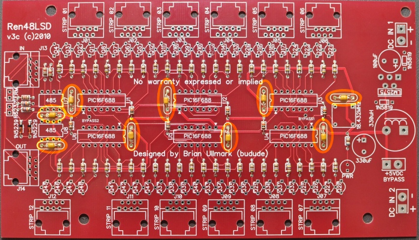

1. Install the six 10k resistors near each PIC  | |||
[[File:Ren48LSD-v3c-Build-01.jpg|850px]]  | |||

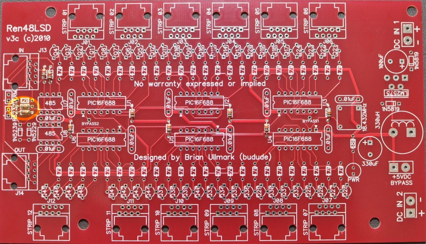

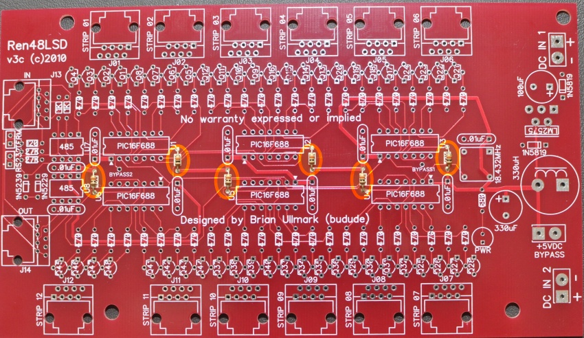

2. Install the two 1k resistors near the 485 chips  | |||
[[File:Ren48LSD-v3c-  | [[File:Ren48LSD-v3c-Build-02.jpg|850px]]  | ||

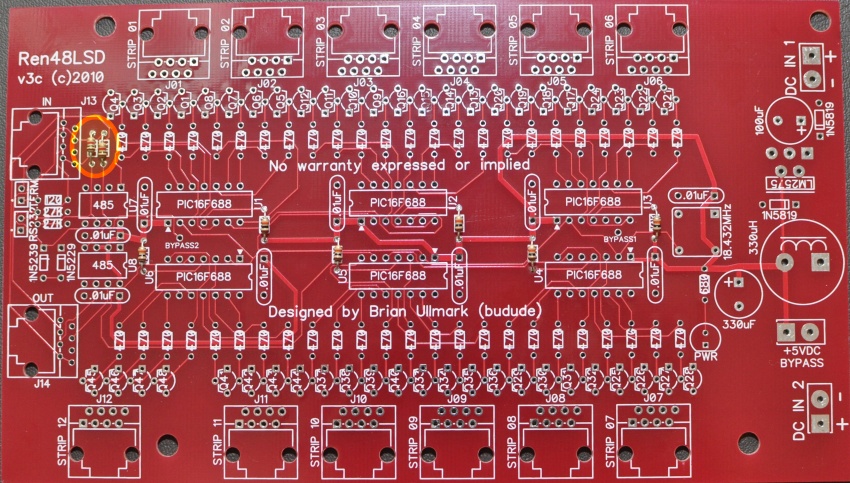

3. Install the two 27k resistors near the 485 chips  | |||
[[File:Ren48LSD-v3c-Build-03.jpg|850px]]  | |||

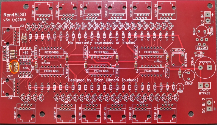

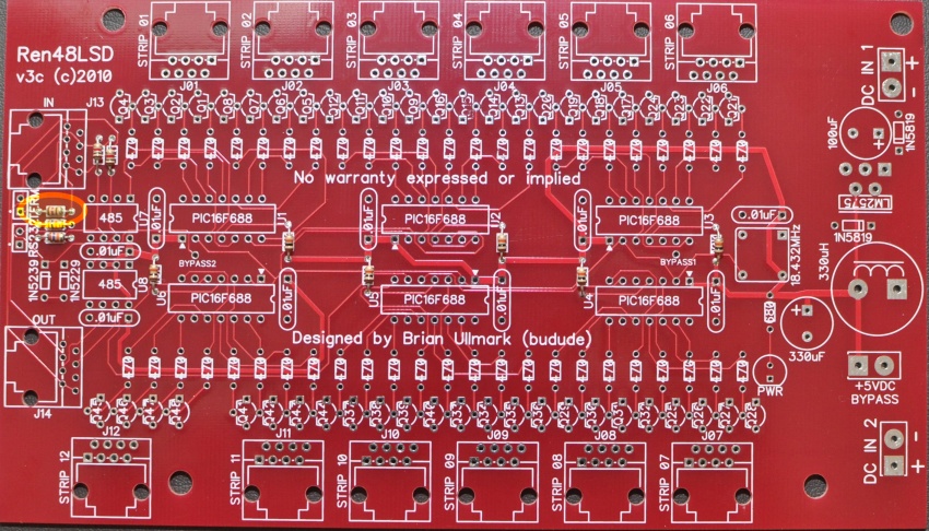

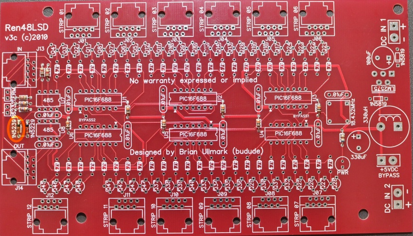

6. Install the 1N5229 diode near the 485 chips – note the correct orientation - the band on the diode goes towards the top of the board in the square hole.  | |||
[[File:Ren48LSD-v3c-Build-06.jpg|850px]]  | |||

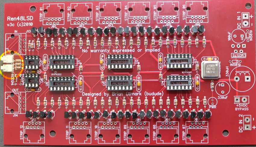

7. Install the 1N5239 diode near the 485 chips – note the correct orientation - the band on the diode goes towards the top of the board in the square hole.  | |||
[[File:Ren48LSD-v3c-Build-07.jpg|850px]]  | |||

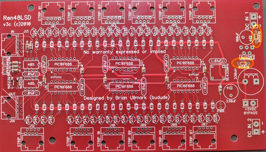

8. Install the two 1N5819 diodes near the voltage regulator '''(Do not install for 5vdc input)''' – note the correct orientation - the diode closest to DCIN1 has the band on the diode facing down and in the square hole, the diode closest to the choke  has the band on the diode facing right and in the square hole.  | |||
[[File:Ren48LSD-v3c-Build-08.jpg|850px]]  | |||

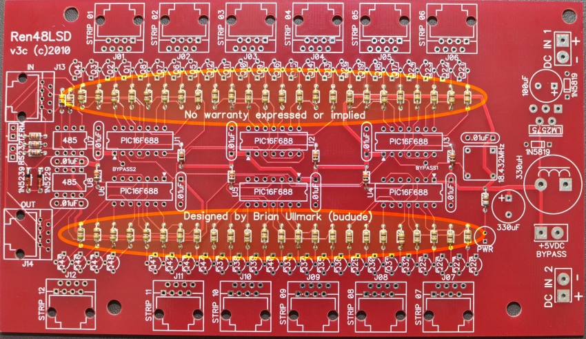

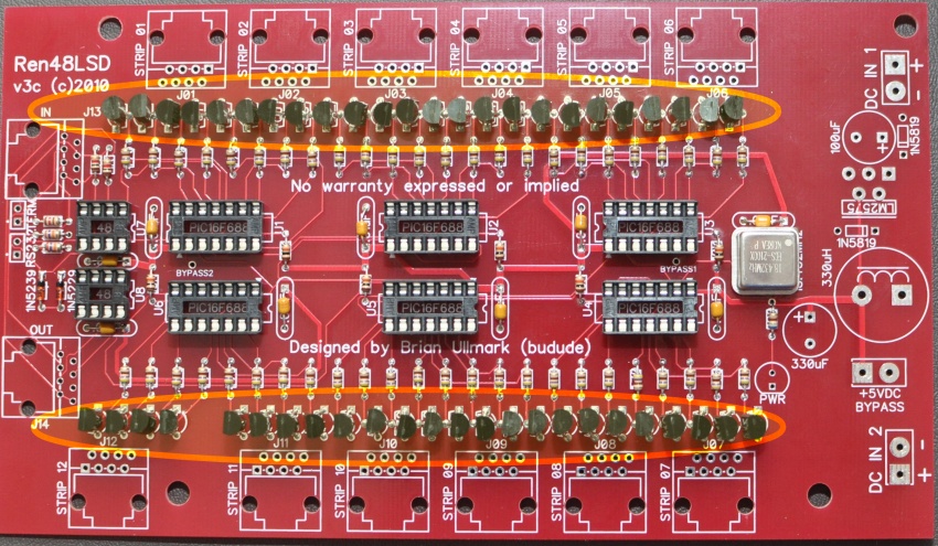

9. Install all forty-eight 470 ohm resistors doing 4-8 at a time.  | |||
[[File:Ren48LSD-v3c-Build-09.jpg|850px]]  | |||

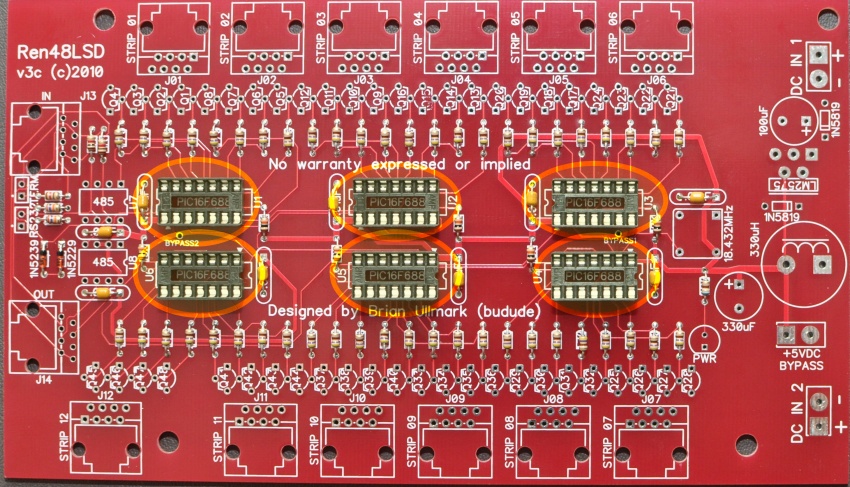

11. Install the six 14-pin PIC chip sockets - note the correct orientation - the top 3 sockets have the notch facing towards the left, and the bottom 3 sockets have the notch facing the right.  | |||
[[File:Ren48LSD-v3c-Build-11.jpg|850px]]  | |||

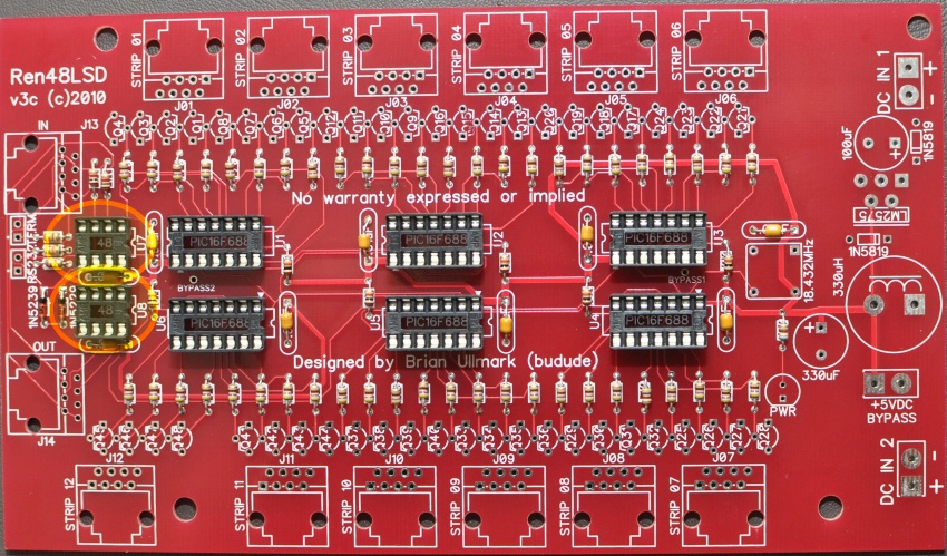

12. Install the two 8-pin 485 chip sockets - note the correct orientation - the notch faces to the right side of the board towards the PICs.  | |||
[[File:Ren48LSD-v3c-Build-12.jpg|850px]]  | |||

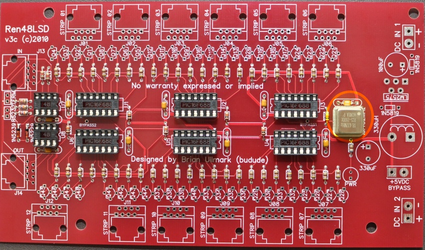

13. Install the 18.432MHz oscillator – note the correct orientation - the package has one square corner (and a dot) and that goes into the square hole on the board  | |||
[[File:Ren48LSD-v3c-Build-13.jpg|850px]]  | |||

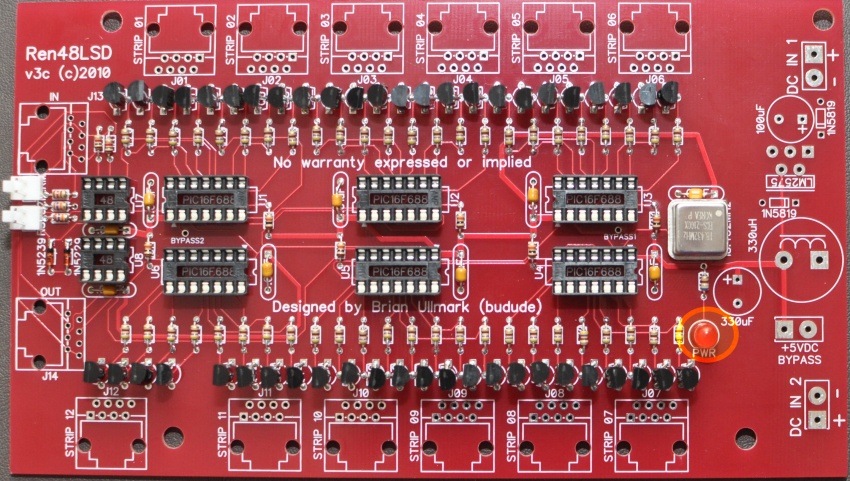

16. Install the LED – note correct orientation - the flat side of the diode faces the bottom of the board.  | |||
[[File:Ren48LSD-v3c-Build-16.jpg|850px]]  | |||

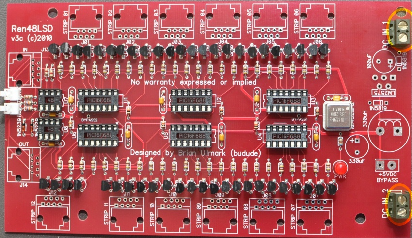

17. Install the DC input terminal blocks – note correct orientation - have the side where the power wires will be inserted facing to the right.  | |||
[[File:Ren48LSD-v3c-Build-17.jpg|850px]]  | |||

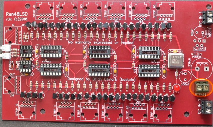

18. Install the +5vdc bypass block '''(Install for 5vdc input)'''  | |||
[[File:Ren48LSD-v3c-Build-18.jpg|850px]]  | |||
Note that if you are using a regulated 5vdc power supply for your input, you should omit installing most of the regulator circuitry.  | Note that if you are using a regulated 5vdc power supply for your input, you should omit installing most of the regulator circuitry.  | ||

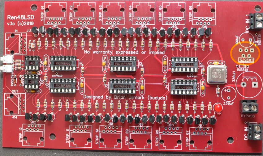

[[File:Ren48LSD-v3c-  | 19. Install the LM2575 regulator '''(Do not install for 5vdc input)''' - note correct orientation - pin 1 is denoted by the square pad - the odd number pins are the pins farthest away from the back  | ||
[[File:Ren48LSD-v3c-Build-19.jpg|850px]]  | |||

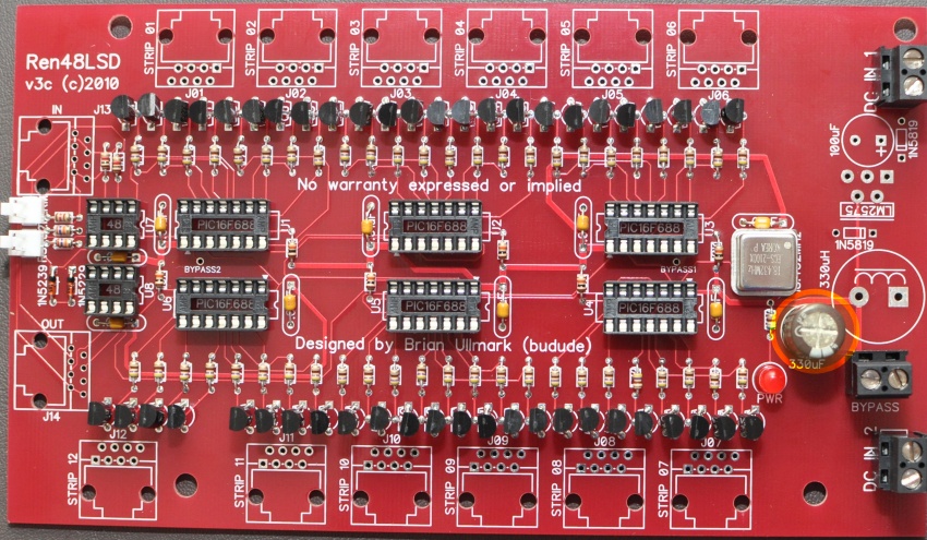

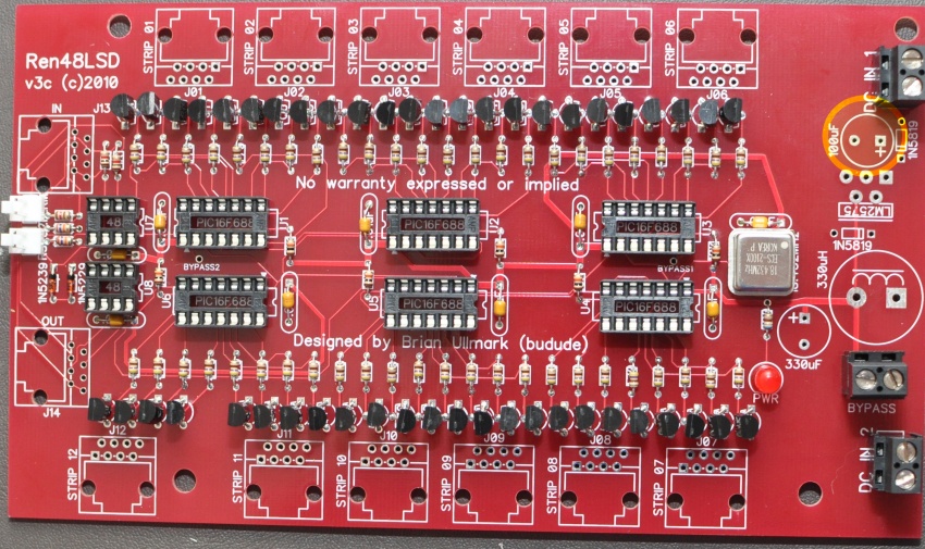

20. Install the 100uF/50v capacitor '''(Do not install for 5vdc input)''' – note correct orientation - the capacitor has a stripe on the side denoting the negative leg that goes in the round hole.  | |||
[[File:Ren48LSD-v3c-Build-20.jpg|850px]]  | |||

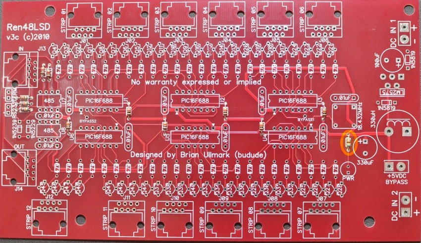

21. Install the 330uF/16v capacitor – note correct orientation - note correct orientation - the capacitor has a stripe on the side denoting the negative leg that goes in the round hole.  | |||
[[File:Ren48LSD-v3c-Build-21.jpg|850px]]  | |||

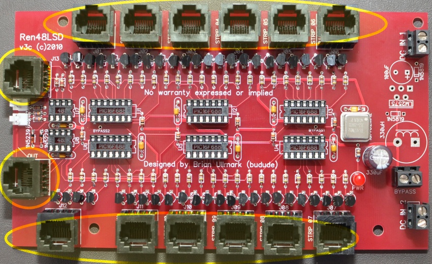

24. Install the fourteen RJ45 jacks – note that side-entry jacks can be substituted  | |||
[[File:Ren48LSD-v3c-Build-23.jpg|850px]]  | |||
