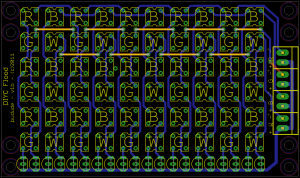

To ensure the best possible color mixing, the LEDs are arranged with the 4 LED colors clustered physically adjacent to each other on the PCB.

PCB
The PCBs for the DIYC Flood were designed by Brian Ullmark (budude).  The PCB was designed to allow users to home etch the board.  The layout can be found here.
