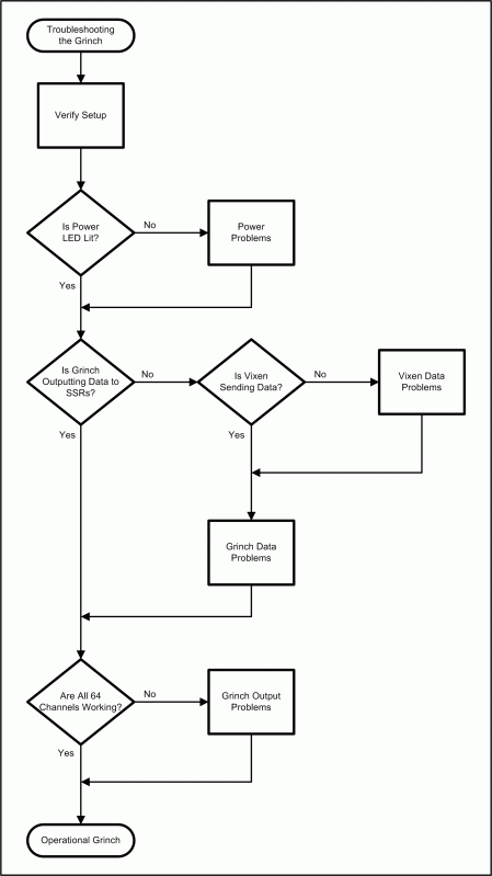

Troubleshooting Method
Verify Setup
- The first step to successful troubleshooting is to ensure that your setup is correct.
- Verify that the Grinch is assembled correctly as compared to the GRINCH Controller Assembly Instructions wiki.
- Verify that you have power/control cables connected correctly as compared to the The GRINCH Controller wiki.
- Verify that you have the Vixen plug-in settings correct as compared to the The GRINCH Controller wiki.
Power Problems

Vixen Data Problems

Grinch Data Problems

- Remove power from the Grinch
- Swap IC chips U2 and U1
- Apply power to the Grinch.
- Restart the Vixen test sequence
- Move the known good SSR or tester to RJ45 connector A
- Measure voltage at U1 pin 5
- Does voltage alternate between VCC and 0 VDC every two seconds?
- If no, replace the IC chip now in the U1 position
- Move the known good SSR or tester to RJ45 connector E
- Measure voltage at U2 pin 5
- If yes, go to step 16
- If no
- If not done already, lower input power (step 10)
- If not done already, provide signal conditioning to parallel port signals (step 11)
- Go to Other Troubleshooting.
- Move the known good SSR or tester to RJ45 connector I
- Measure voltage at U3 pin 5
- If yes, go to step 19
- If no
- Stop the Vixen sequence
- Swap IC chips U3 and U1
- If no
- Move the known good SSR or tester to RJ45 connector M
- Measure voltage at U4 pin 5
- If yes, the Grinch should be operational
- If no
- Swap IC chips U4 and U1
- If no
Grinch Output Problems
- SYMPTOM(S):
- Some outputs not working correctly
- POSSIBLE PROBLEM(S):
- Connected to a bad SSR
- Bad IC chip
- Bad trace or solder joint on pcb
- TROUBLESHOOTING STEPS:
- Ensure that the input data cable is connected.
- Connect SSRs or testers to all outputs that you want to test.
- Run the Vixen test sequence created in the Vixen Data Problems section.
- Monitor the SSR outputs or testers
- Are SSR outputs or testers turning ON/OFF every two seconds?
- If yes, the Grinch is operating correctly.
- If no
- If only individual outputs are failing, go to step 7
- If groups of outputs are failing, go to step 8
- Replace SSR or tester that is indicating a failure with a known good SSR or tester
- If SSR or tester is still indicating a failure
- Inspect pcb for bad trace or bad solder joints
- Replace corresponding IC chip
- If channels 17-32 are all failing
- Replace U2
- Verify Grinch doesn't have data problems
- If channels 33-48 are all failing
- Replace U3
- If channels 49-64 are all failing
- Replace U4
