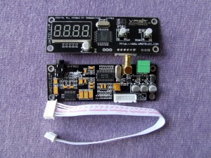

The FM02 is a two board FM transmitter. It accepts a stereo audio source and outputs a stereo FM broadcast signal on the frequency shown on the LED display. It comes just as shown in the picture above.
It is rated at 30mw (that's milli-watts) of transmission power. For most Christmas DIYers this is a nearly perfect amount of power. It will transmit a clear signal for about 2 blocks or 1/4 mile. Why is this good? Because it is illegal in the USA to transmit other then very low amounts of FM radiation without an FCC license.
Skip to this section for more details: [FCC Rules]

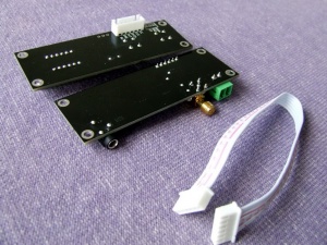

The FM02 is not a complete unit ready for use. Instead, it bridges the gap between an out-of-the-box solution, and a build-your-own unit that starts with a bare PCB and a bag of parts.

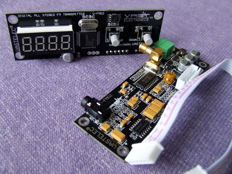

The FM02 is very small, but packs in a nice set of features.
Key to these is the use of PLL (Phase Locked Loop) technology. PLL keeps the transmitter locked into the designated transmitting frequency without it drifting up or down. This frequency drift WILL occur on other FM transmitters without PLL as the temperature around the unit goes up or down.
The second key feature is the fact that the transmitting frequency is maintained even after power is turned off and back on.
The FM02 is a very sophisticated assembly. Building a unit of this capability and size would be nearly impossible for most DIY'ers.
So, to create a usable FM transmitter, the FM02 needs some help. The builder of the transmitter will take the FM02 and use it as the corner stone of a complete transmitter.

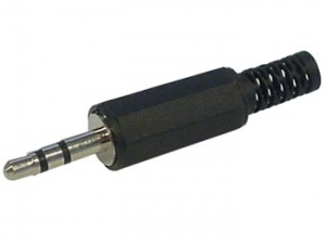

The FM02 has a standard 3.5mm stereo jack for the wire that is carrying your audio signal.
There is one key point about the audio. It works best with a line level audio input. The Audio Out jack on a PC is NOT line level. Line Level is a very low volume level signal. The Volume level on your PC needs to be set very low, barely audible. If you overdrive the audio signal, it will result in a FM transmission that will sound distorted.

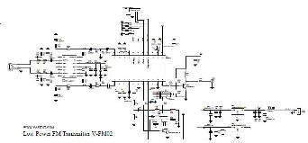

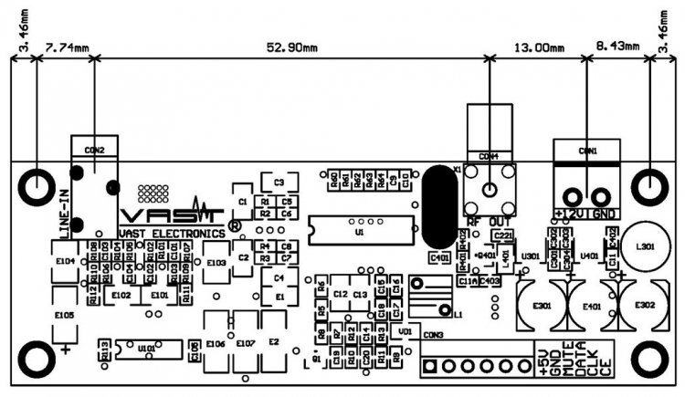

Schematic and PCB layout
The schematic and PCB layout are documented in a .pdf file.
This document shows the electronic board schematic and the PCB layout for the main transmitter board.
What is not shown is the information for the 'Display' board of this two board set.
[Click Here for the full Schematic & PCB layout File].

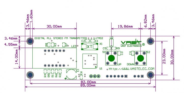

Detailed Board Dimensions
Outline of the 'display' board.
The second board has the same physical outline dimensions. It also lines up with the 4 corner mounting holes.
Here is a pdf file that contains a scale outline that will serve as a template for the display board. You would use this to create your own bezel if you want to dress-up your installation: [Bezel Template]

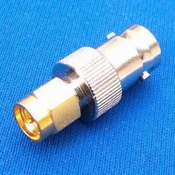

It is important when attaching an antenna/converter/cable to this connector that you do not over-tighten it. The outer part of this connector is a 'press-fit' part. It is possible to simply defeat the resistance of the press fit and cause this part of the connector to fall off! So, if you use a wrench, be very careful, the connector is rated for INCH Pounds of torque.
Most DIY'ers will want to convert this to the BNC type of connector because BNC components are easier to find.
The converter shown below will correctly hook to the FM02. SMA is the smaller gold colored part of the connector. You can purchase the adapters from diyledexpress.com or from ebay.

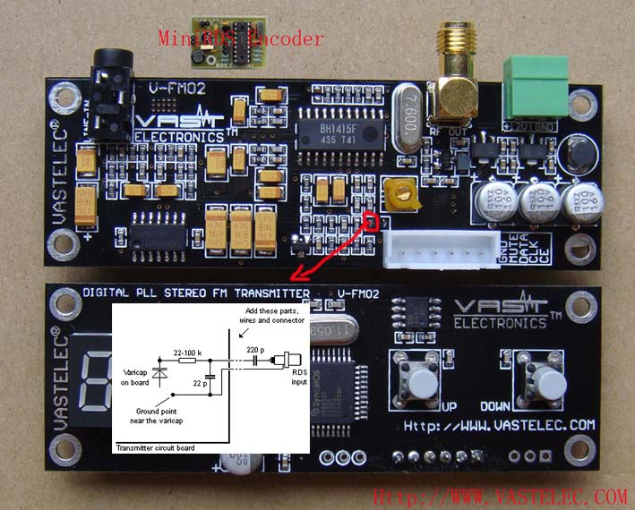

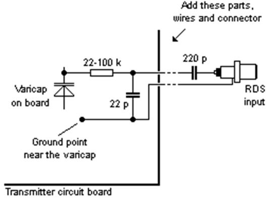

RDS hookup information
This section involves modifying your FM02.
If you do this, you void the warranty.

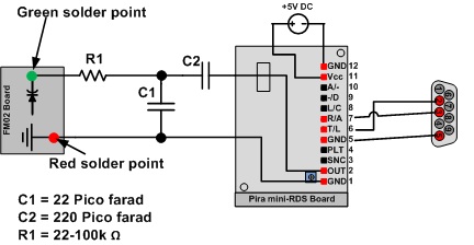

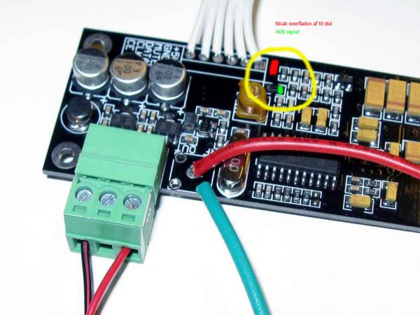

Here is a picture of hooking the pira mini-RDS unit up to an FM02
The green spot on the PCB is the RDS data hookup point.
The red spot is a section of the PCB that was scrapped away revealing the copper. This is used a a soldering point for the ground.
Another View of the GREEN RDS connection spot: Notice, the insert showing the full schematic of the hookup. Two capacitors are needed as noted. (220 picofarad and 22 picofarad) The resistor can be any value within the range noted.
Pira Mini-RDS hookup diagram:

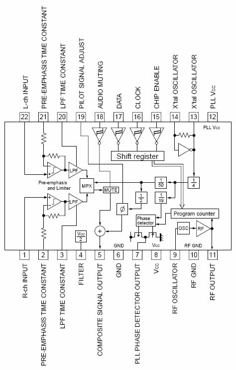

The "shhhhh" issue is not a power supply problem, or audio source problem. The problem is the 19Khz pilot level on the BH1415 chip.
I recommend everyone download the BH1415 data sheet and look at the chip's block diagram and pin layout in order to follow along in solving this "shhhhh" problem.
Pin 19 is the 19Khz pilot tone level. By default, this pin is at a high capacitance state when left open. This pin adjusts the 19Khz pilot level. When it is left unconnected, the pilot level is 30+ percent above the standard 10 percent of modulating the carrier. If the pin is connected to a surface chip cap, this cap may be open or has changed value thus the 19Khz level is still too high.
In order to correct this, a proper modulation monitor or O-scope capable of 100Mhz or more will be needed to adjust properly.
The best capacitor value I have found that brings the 19Khz pilot level down to its standard 10 percent level is a 220pF. The pilot rides at around 11.3 percent. A far cry from the 30+ percent.
Connect the capacitor between Pin 19 of the BH1415 chip and ground.
