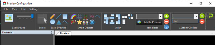

15 - Custom Objects drop down shows the 'Face' we just created
attachment.php

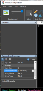

17 - String type set to pixel... now lets edit the linked elements
attachment.php
