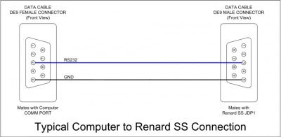

Typical connection between computer running Vixen and Renard SS24 boards

Data cables for Renard SS board hookup directly to computer COMM port
PC DE9 Pin 3 to Renard SS DE9 Pin 3
PC DE9 Pin 5 to Renard SS DE9 Pin 5
PC DE9 Pin 3 to RJ45-pin 4
PC DE9 Pin 5 to RJ45-pin 5 and pin 1 and/or pin 2
