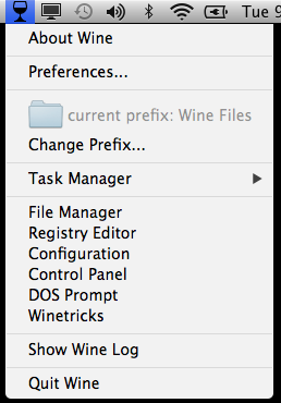

Figure 1
  • This will place a wine glass in the top-right of your screen. Click it and select Winetricks. (See Figure 1)

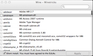

Figure 2
  • In Winetricks (See Figure 2), search for and install the following files in order:
    • msxml3
    • wsh56js
    • wmp9

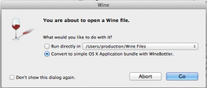

Figure 3
  • When opening the file with Wine, Choose the option to Convert to simple OSX app. (See Figure 3)

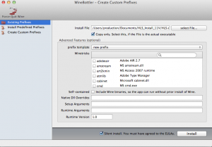

Figure 4
  • In the window that opens, check the Copy Only, then click Install. (See Figure 4)
  • Name the file HLS, then click SAVE.

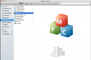

Figure 5
  • This will create an application that you can now open like other installed apps. See Figure 5
