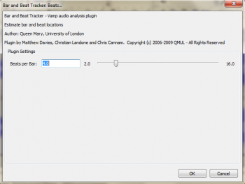

- Click Analyze -> Bar and Beat Tracker: Beats...
- The window shown in Figure 10.5-1 will appear. Select the beats per bar. This will place the specified number of labels for each measure of music. For example, if you choose 4, and there are 4 beats per measure in the song, you will have one label for each quarter note. Setting this to 8 would give you one beat for each eighth note, etc.
- (Audacity will now analyze the file to determine the beats.)
